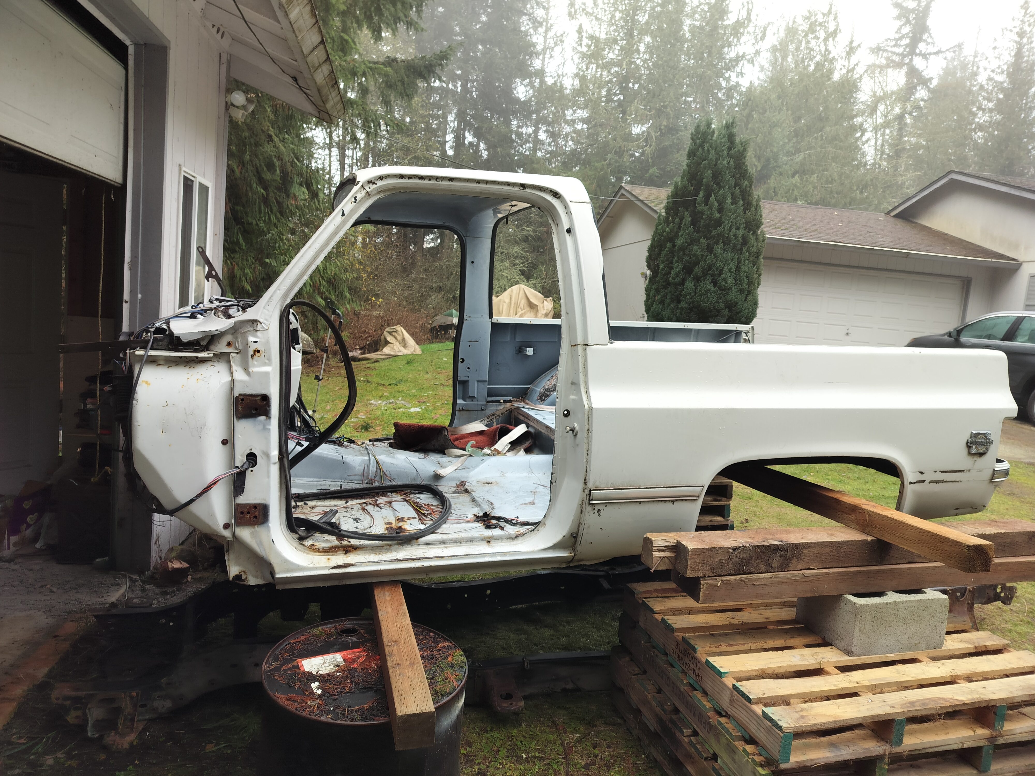

Having a K5 tub sitting on pallets and 4x4's in my yard awaiting tearing my running k5 down to swap in a boxed frame and this tub, it seems to me like it would be a lot easier to deal with most of the drivetrain stuff without the sheet metal in the way.
I also have to do some work on the sheet metal, any necessary is going to be much easier with the tub separated, particularly around the wheel wells and underside. (Not in the below configuration!)
Totally not sketchy lol

That's actually not bad compared to some crazy stuff I have done before

It's actually very stable. Am I gonna crawl under it and start banging on things? Hell no. Lol. I did run out of pallets, with a few more, it would have had a very solid footprint. Surprisingly easy to pry a corner of the body up with a long 4x4 and a fulcrum which made adjustment easy.
I was able to remove that tub and frame from a trailer with a floor jack, separate the frame (wasn't bolted together, but still a hassle with no ability to lift the body straight up in one motion), and with another set of hands get it into that position. It's a bit of a hassle, but for the OP, you can certainly come up with something that works for your situation for minimal cost.

And some of my jobs I definitely wouldn't go under, but yours here from what I can see, I would go under it
It was far easier to move that K5 body using a tractor with a loader. But I've done similar stuff to the pallets and 4x4 lumber to move large bodies on/off trailers before, when I wasn't spoiled by hydraulic assistance.
