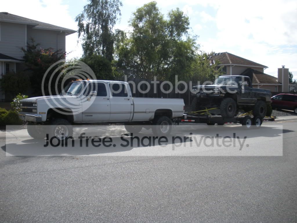

Yeah I'm towing with the Crew Cab. Trailer has no dovetail and the rear tires are right about to the fenders. Front tires are probably a few feet from the front. The suspension on the Crew Cab squatted a few inches where it sits.
Here is the trailer.

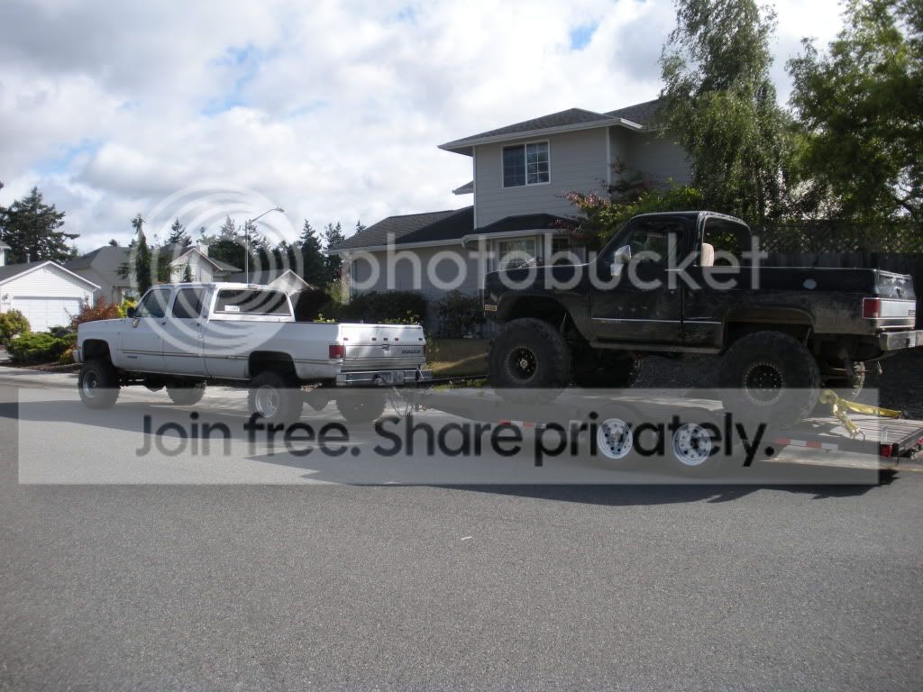

Here's mine, 18' trailer and the rear tires are overlapping the trailer fenders.

Mine is pretty close to yours John. I think my trailer has a bit more deck forward of the axles. My tires are pretty wide so I can't come much farther forward without parking on the trailer tires :o
My Crew Cab has pretty stiff rear suspension and it is squatting a bit so I know I have a good amount of tongue weight.

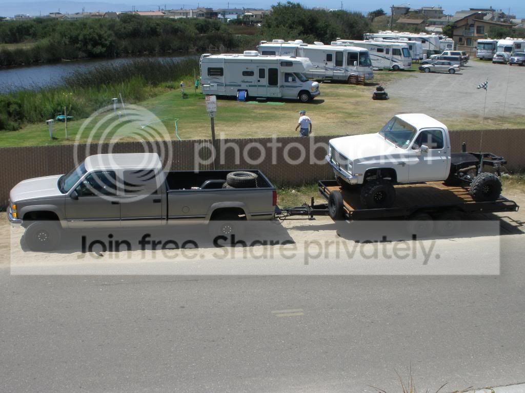

On another note you might want to look into putting a weight distribution setup on the trailer down the road. I borrowed my friend's trailer (chevysmithz71 on here) and I've used it with and without the distribution setup and it's night and day.
Here is where I set my k10 when using his trailer with the weight distribution torqued down.
This is from our last trip (it's the only pic I have of the setup so sorry it's far away) and as you can see this is about as far back as I like to go.

OK, now here's mine. (From my post above). There is about an inch of squat on the truck and it is an 84"x15' 10K lb car trailer. Tows great too.

Looks good to me, if it pulls good at hwy speed let'r fly.
Btw, that K5 is just plain secksy!! :bow:
