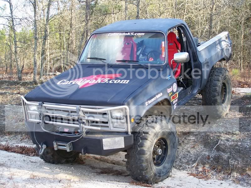

I found these pictures on here but for the life of me cannot locate the thread. Anyone know whos these are? I think these are all from the same person.
Does anyone have pictures of a 44's on h1's on a SRW front axle no spacers at full lock? Wondering what angle the front wheels would be at before hitting the frame/leaf springs? Thanks.
thosea are recenter h1 rims and usa 6x6 inserts.
