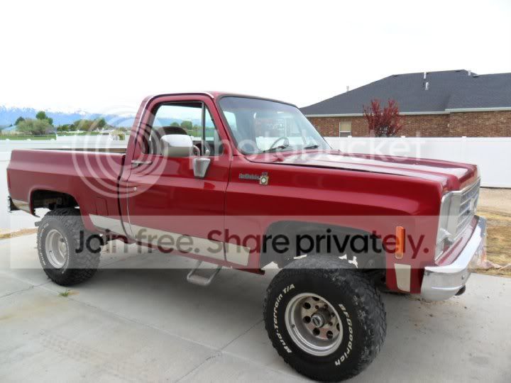

my dad bought this truck back in 77 with 12,000 miles on it. since then he has restored it but he says its a hd 1/2 ton is this true? i didnt know they made them. :confused: and if so whats make them different

now that i think of it. i think thats what he called it, a "heavy half"... i will have to ask him more about it because this is a 6 lug shortbed.
on a side note it does have flattop knuckles dont know if that makes a difference i dont think so :dunno:

i just talked to my brother. (he is the one who restored it with my dad) he said that it had more leafs in the pack.
is there a way to check it by the vin? or any special numbers on the frame?

thanks. its getting to need another restoration lol. its kinda neat, my dad restored it with my oldest brother and then gave it to him, then once my oldest brother got married he gave it to my 2nd older brother and now he is married and gave it to me, im the youngest. i also plan on keeping it untill i have kids someday and give it to my first son when he gets older. :waytogo:
anyways the tag on the cab says gvwr is 6200 gawr front is 3580 and rear is 3580. its along with the vin so im pretty sure its not switched. the stock rear leaf springs are still on the truck with 4" block :doah:(need those gone) but they have 6 leafs in them

besides that, my dad had a 72 gmc long bed 2wd that i believe said heavy half right on it. it was on the front fender i think. i cant find replacement emblems though so i may be mistaken:dunno: that was a long time ago.
I have a '79 Heavy Half Big Ten 2 wheel drive long bed that my parents bought brand new off the lot. It has more leafs in the rear and different coil springs up front with a small block.
maybe im going to have to call her the "heavy chevy" instead of philis :haha:
its just seems weird if this was a true heavy half why is it 4x4 while everybody elses is 2wd and no one else has seen a 4x4 shortbed.... makes me wonder if i have rare truck
Seems like in those days you could order pretty much anything. All that had to happen was to check the 6200 GVWR box and away you went in your big 10 short box 4x4. I'd imagine it's not incredibly common though.
