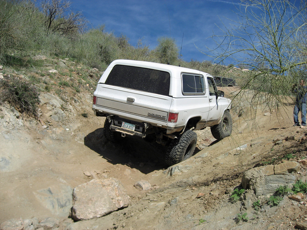

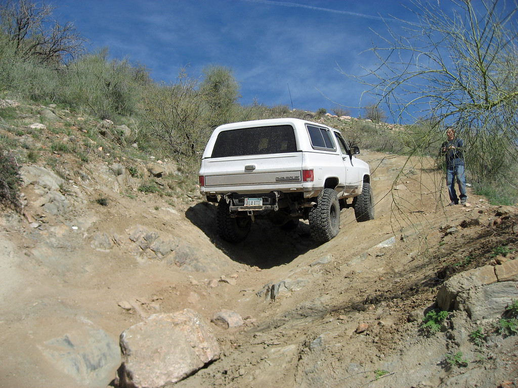

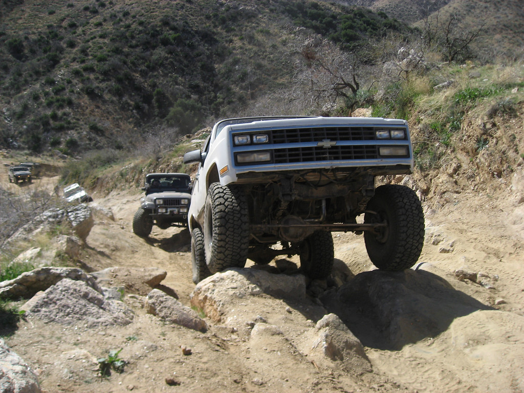

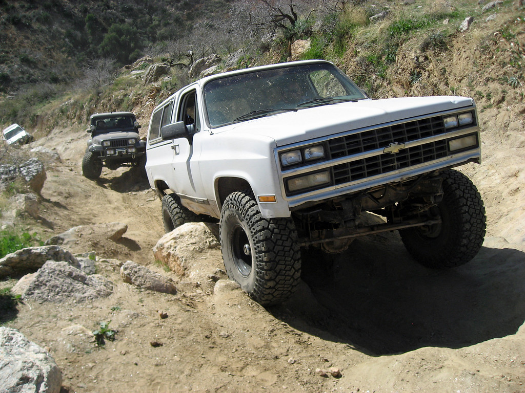

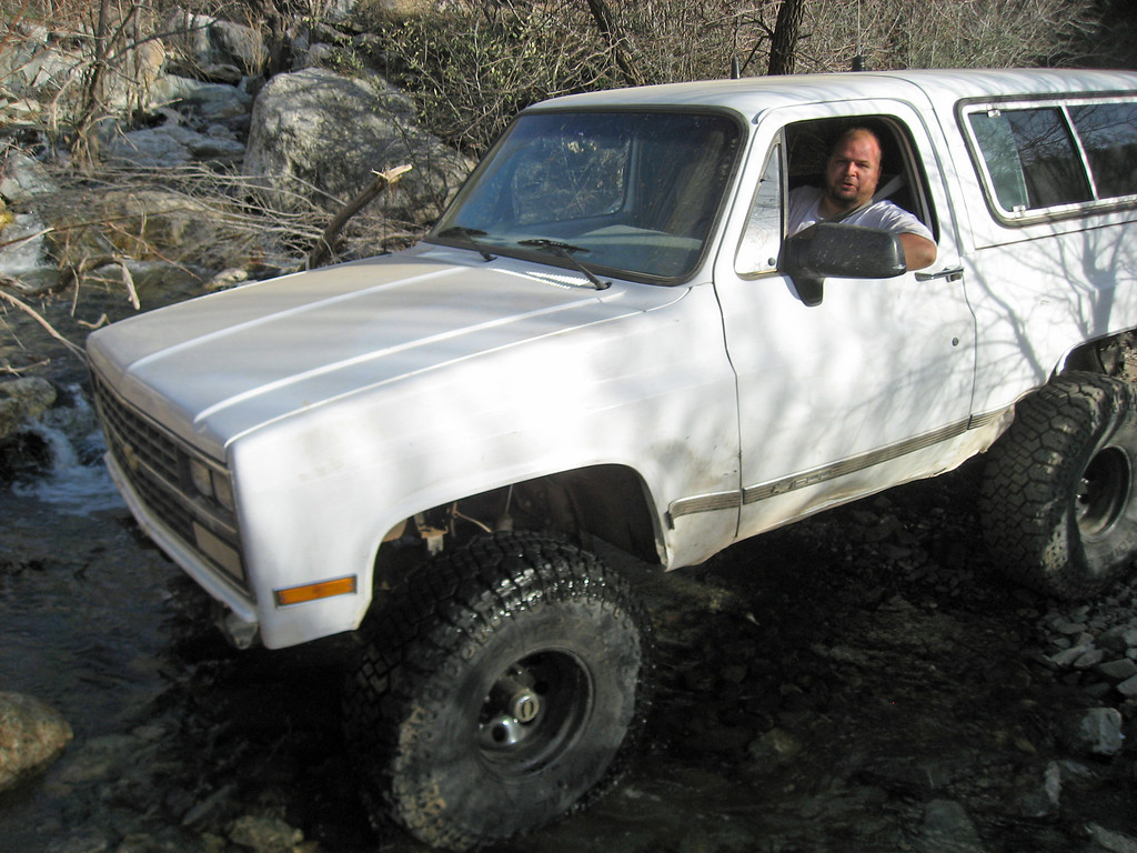

Tomorrow I will get the muffler welded on. I plugged it onto the pipe just to see how it sounds and... I LIKED IT! Nice mellow throaty big-block sound. I also need to get my VSS hokked back up so I have a working speedo again. I will be taking her on her maiden oil-burning wheeling trip this weekend, so we will see how it goes![]()

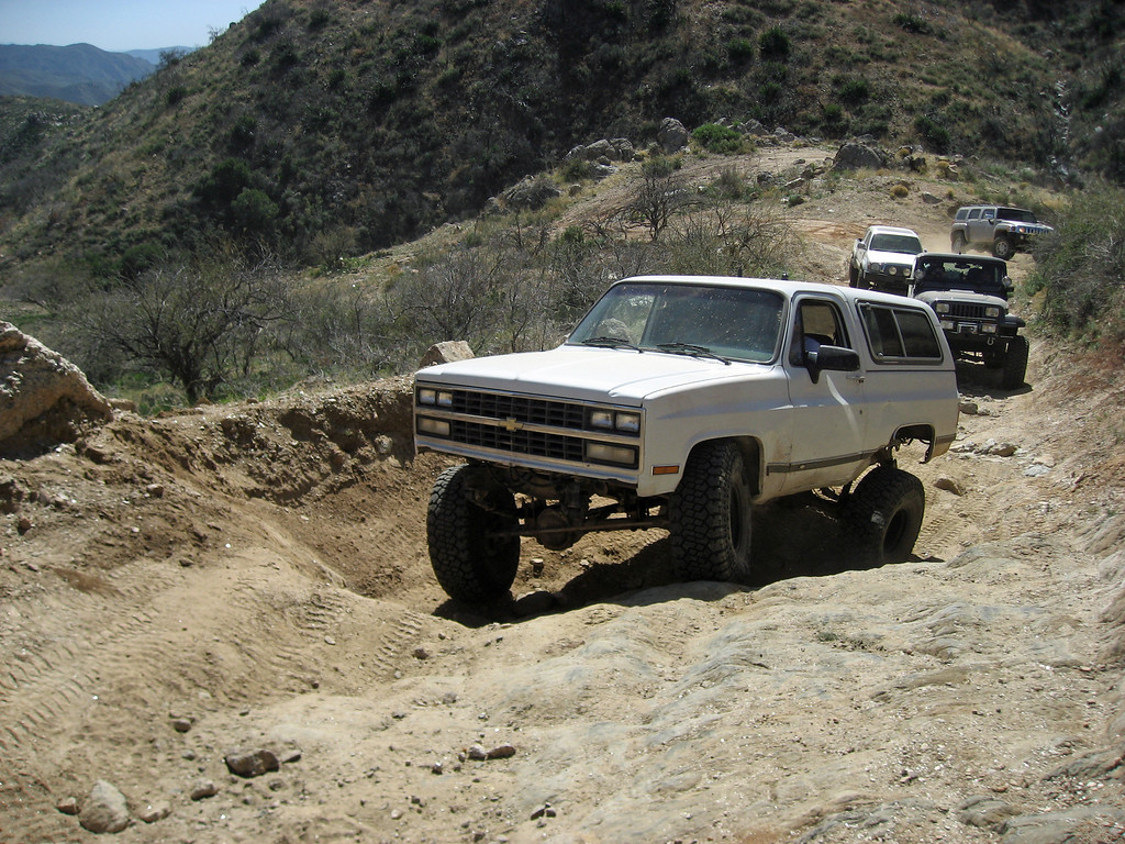

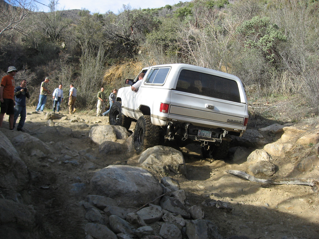

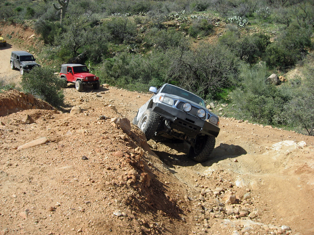

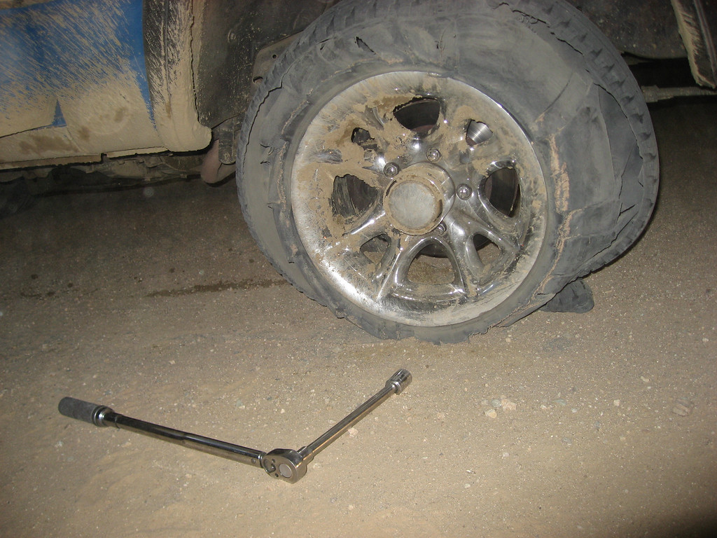

. It has plenty of desert pinstripe and skidplate rash, as well as chunked tread to show for it

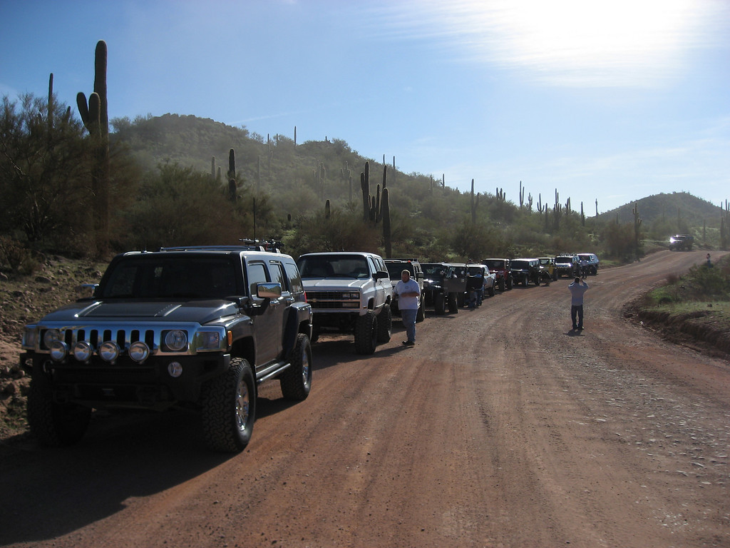

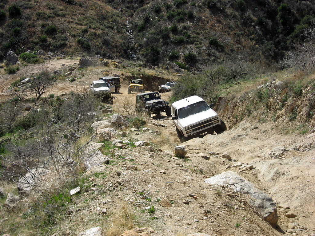

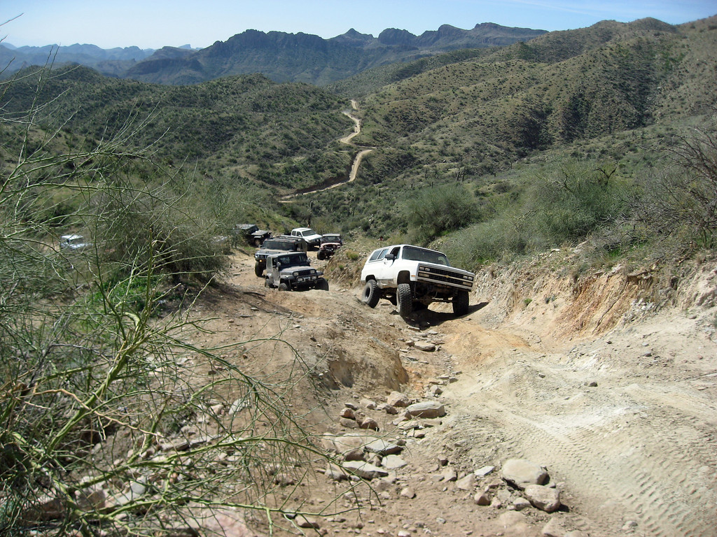

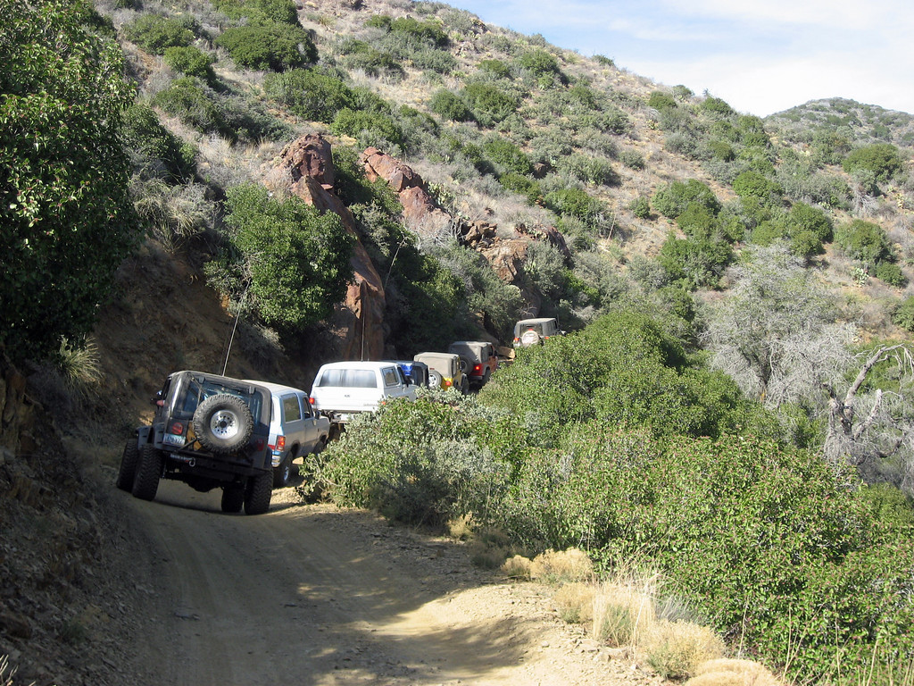

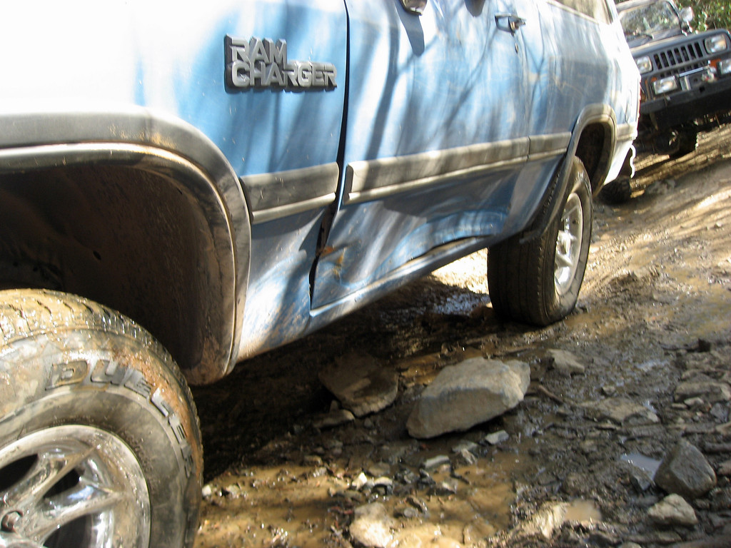

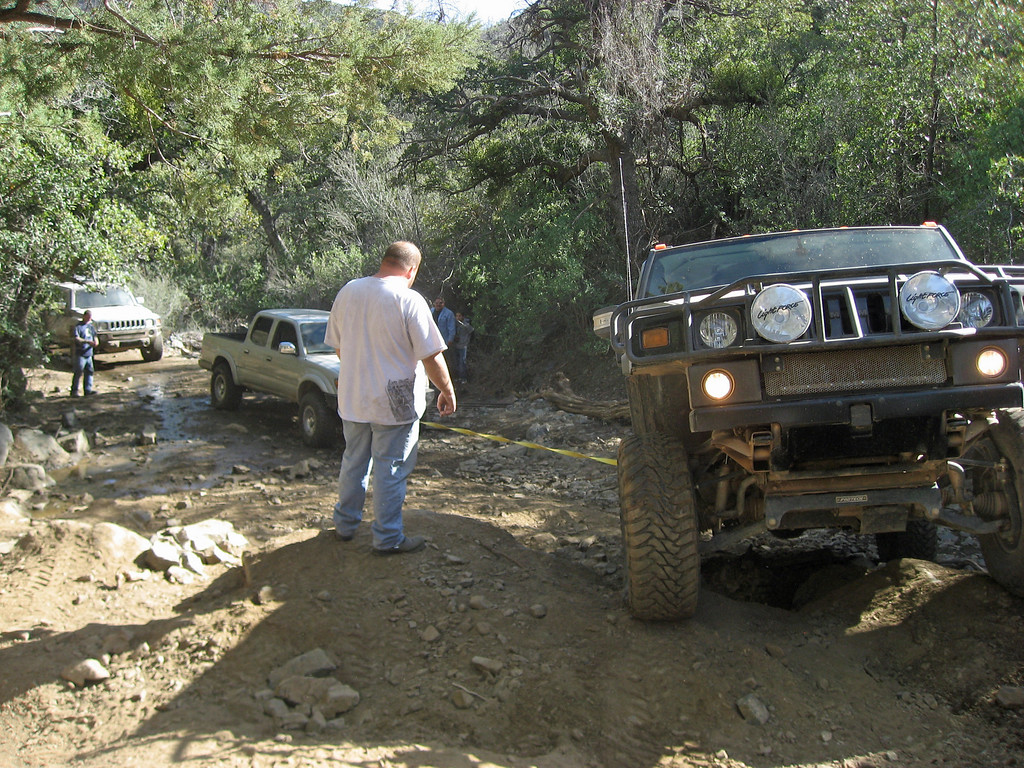

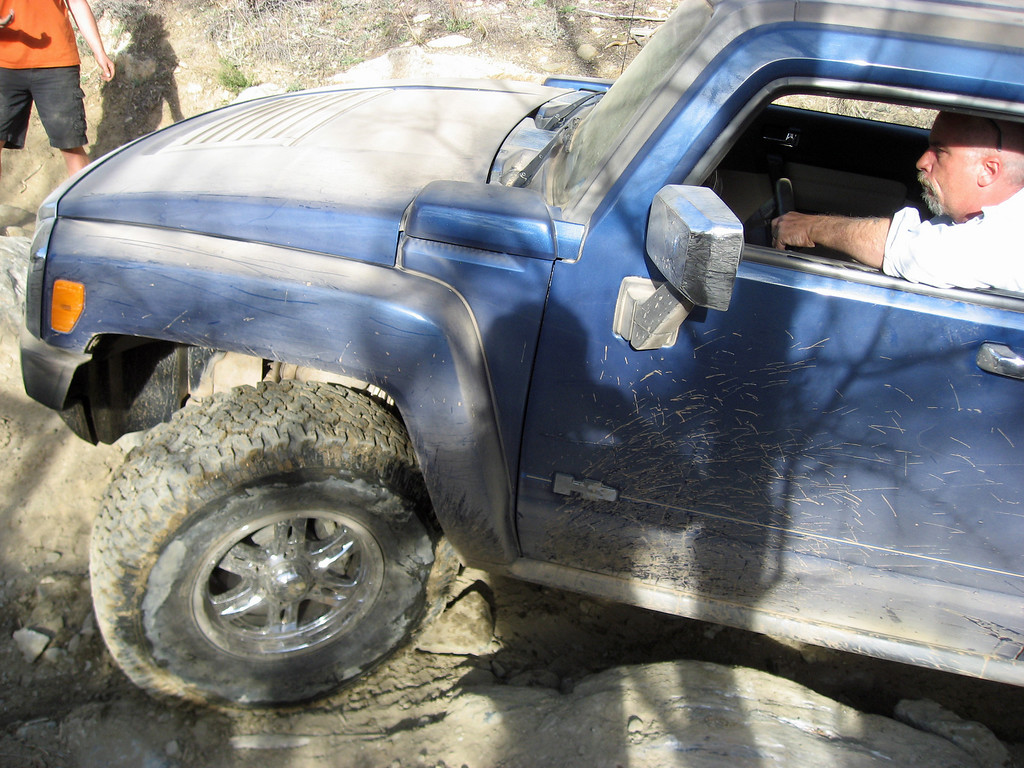

Next in line is yours truly, followed an H2 on 37's, my good friend Todd in the CHeep (the only thing still Jeep is the frame and tub - the rest is all Chevy), a Jeep TJ, a Toyota Tacoma that is lifted and locked, another TJ, a brand new 4 door JK Rubicon still sporting the paper temp license, yet an other TJ, another H3, a Dodge Ramcharger, and finally a lifted, modded H2 shod with 38's. Another H3 caught up and joined us about 20 minutes into the jaunt, for a total of 13 rides.
