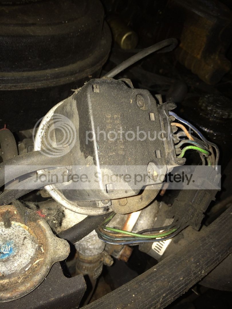

I just bought an 84 Jimmy with a 6.2, I know the PO and he says it's been sitting 2 years and he has no doubt that the drivetrain is fine. He says it should crank up but needs a new glow plug relay and something he described as a "fuel distributer" it's the thing that sits on the top of the motor in the front ( front of truck) it looks kinda like a distributer without the cap but has wires coming out the top, I'll post a pic of it later. I need to know what it's called so I can buy a new one. Anyway, what else do I need to do before cranking this baby? I have no experience with diesel motors, this is my first one-however I know my way around a gas engine and from what I've read the 6.2 is not hard to work on. So tell me what steps I should take to get this thing cranked up. Thanks

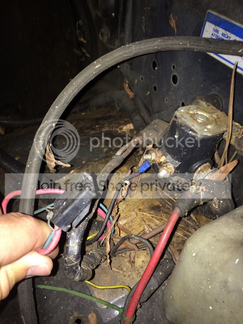

Glow plug relay can be bypassed. Take a pic of the solenoid on the drivers inner fender and post it up. There should be a light blue wire running from that solenoid to the back of the engine. With the key on, if you ground that wire the glow plugs come on.

Thats the injection pump according to other posters in this thread
That appears to be the cruise control vacuum module.
