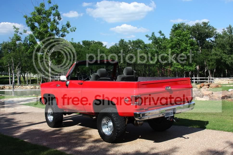

On another note, your red K5 looks awesome! I am trying to restore my dads 73 and when I am done I want it to look like yours. What tires/rims are you running and how much lift? Anything special under the hood? Great looking rig!

Thanks for the compliments on the truck man. It is on 16" Eagle Alloys with 33" BFG Mud Terrain KM's with a 4" spring lift.
I'm going to 35's next time round and I think I'll be done with the shoes at that point. Overall I'm really happy with this set up even on the 33's. I really can't take credit for it though as the previous owner was the one who did the lift.

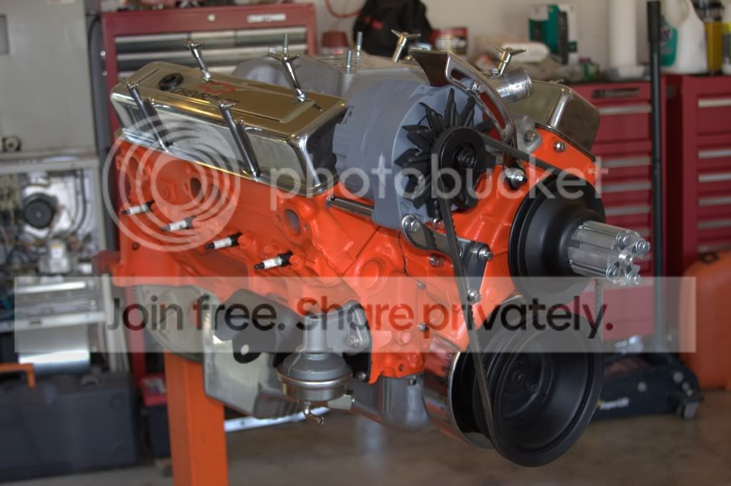

And it just so happens as of this week it has a fresh 350 in it. 4BM, Edelbrock 650, Weiand Intake and Thorley Headers. That is all from the previous owner too except the engine which blew up so I replaced it with a reman.
