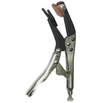

I just did this... filled and smoothed about 50 holes in the frame... plugweld pliers come in handy..
Looks like a great tool where there is access. For the middle of the C section I'm not certain they would reach. Sounds like I'll find some mild steel washers or a block of copper for the rosette welds.

I've had a set for years.. they used to make a widethroat bodyclamp one years ago that got stolen from me.. but I since think they've discontinued them, haven't seen em.... handy tool....

I picked up a magnetic plug weld tool and it worked like a charm :)
