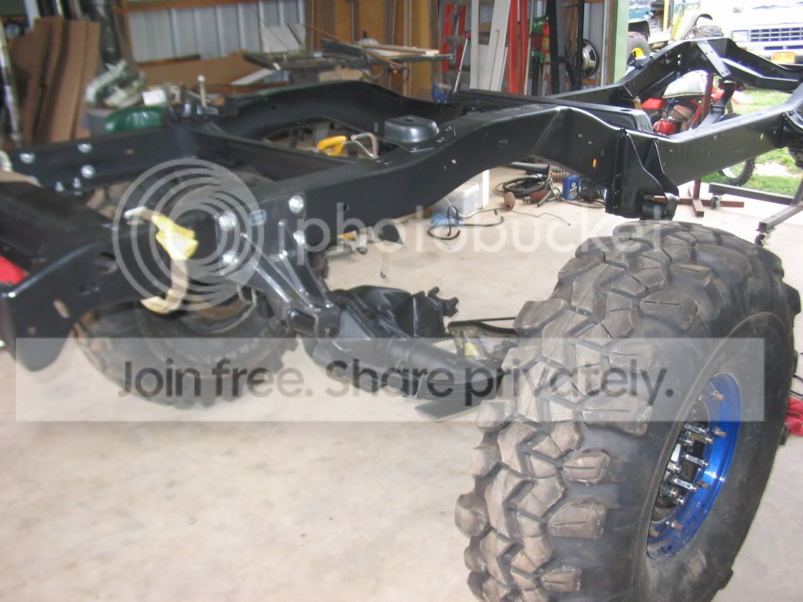

Any of you out there take your k5 totally off its frame? I'm gonna be doing it in my shop with plenty of room. Just wondering if anyone has some direction they can send me in to do this safe.
I want to go from this
To this
Any suggestions will help

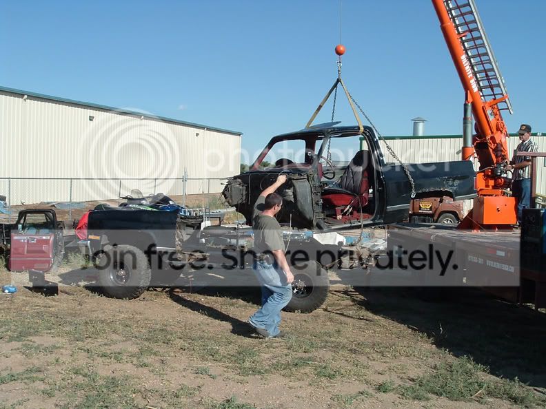

B_to_C said:
This is how I did it...although it might not help you much...
Well,
I do have access to a large skytrack which could do that without a problem, it's just I dont wanna put that much pressure on the room and deffinitally no chain on the rear fenders, Body is in real good shape and don't want any dents yet, I know they will come eventually though.
For what it's worth, as far as I could tell the roof did not bucle at all but the chain definitely dented the quarter panels
