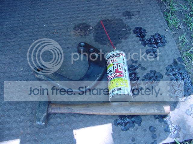

like this sissy!!! I hit the numbers :D I decided that I would go ahead and do the most fun part first. I messed with it a little last night, but when I got out there in the daylight, (the PB had time to soak in overnight), No more than 20 seconds of hitting, and the arm popped all 3 cones out of its tapered area. Easy as pie :p:

It must have been wrapped in a protective cocoon of motor oil, because my floor has a hole you could drop a soft ball through :eek:
