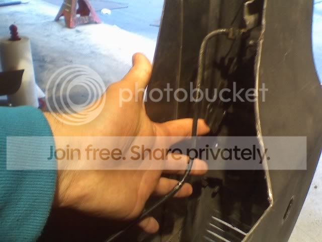

Im in the process of building half doors right now, im gonna try to get together a write up for it soon.
but as for latches i kept the stock latching assembly but i bent the rode that actuates it in order for it to fit inside the door. it sounds weird but ill get pictures tmw.

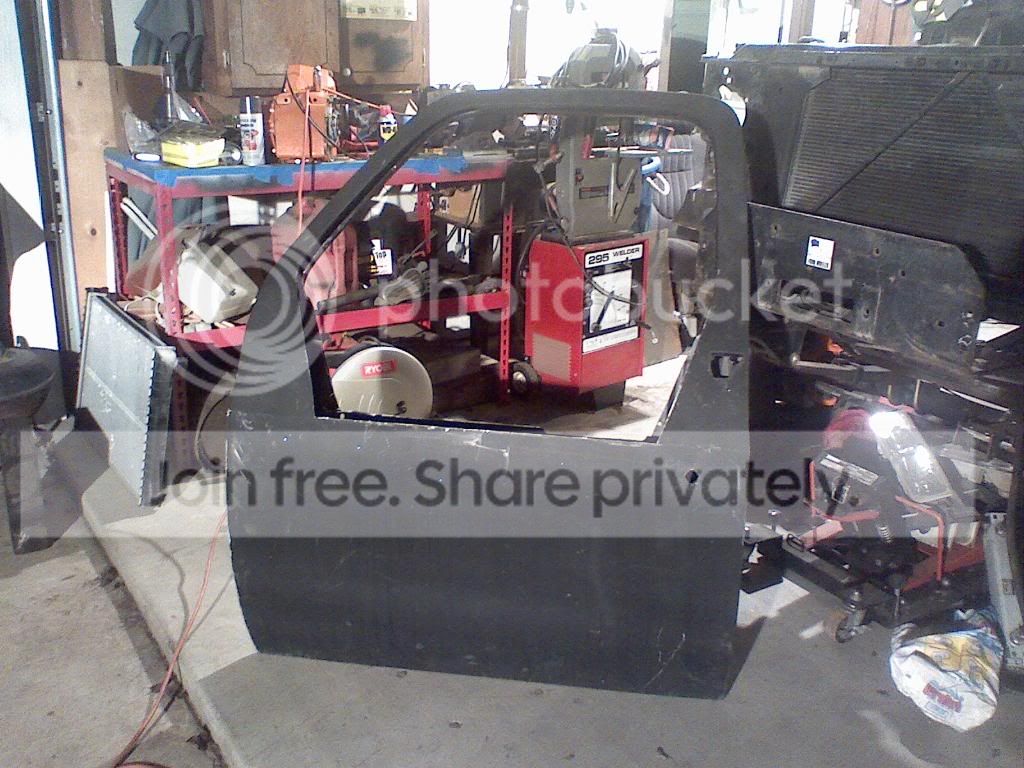

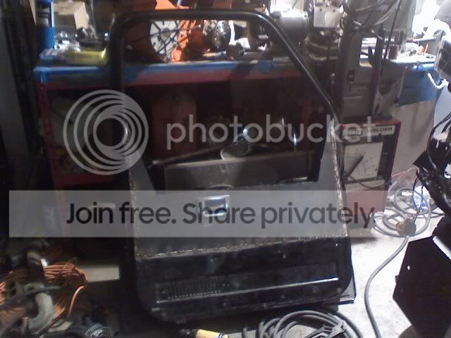

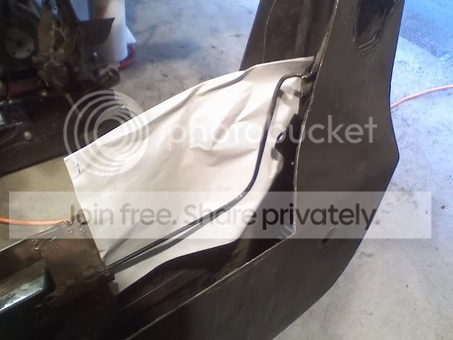

Here are some pictures of the way im building my half doors. just to give u an idea of the way i have my latch assembly hooked up, keep in mind if u decide to go this route u have to do some thing about the locking mechanism. I opted to just weld mine in the unlocked position.
I guess my doors would be considered 3/4 doors? they dont go down as far as some other doors ive seen.
i like the way you're doing yours. what will you do for an exterior latch? or do you not feel you need one since you could reach inside?
i need to do both exterior and interior latches because i'm going to do soft skins for the window area since mine needs to be all-weather.
Im probably not going to do exterior latches but if i were going to i would most likely cut the original door handle to match the angle of the cut in the door and just use the original door opening button thing :confused: bad explanation i know. ill cut it up and get some pictures up soon.
Now that i think about it i just might do exterior latches :haha:
