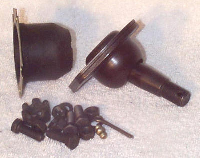

Same A-arms , different ball joints . Disc brake truck spindles take a longer thinner shaft ball joint .
Disc brake spindle ball joints :

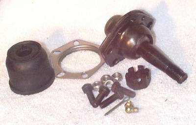

Drum Brake spindle ball joints :
