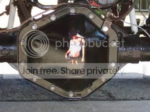

SF cover looks like an egg. FF looks like this

Well, my cover seems to be lacking some of the deTAIL that your's has. /forums/images/graemlins/rotfl.gif But I definitly have have an FF. Feeling much better now. Thanks.

LOL. Never heard that before /forums/images/graemlins/rotfl.gif Its not even good pic, the diffs not centered, and you cant see the rest of her body that good. But I guess you can see what matters?! /forums/images/graemlins/dunno.gif /forums/images/graemlins/thumb.gif
