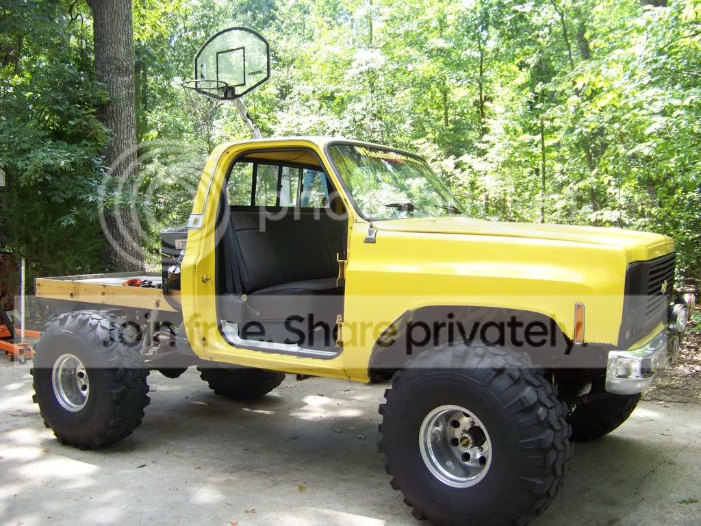

ok i had my blazer which some of you may remember but i got a great deal i couldnt pass up on a 77 chevy flatbed from 58apache on here...here were the specs when i got it
400sbc,small cam headers,h pipe,no cats,single chamber flowmasters
diy shackle flip with 6 inch shackles
6 inch front springs
half ton running gear locked 12 bolt
465/203 :D
windstar fans

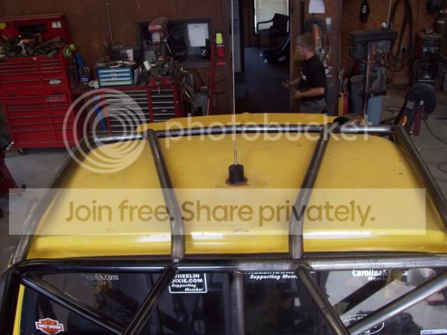

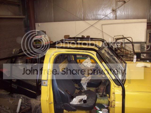

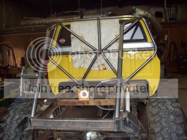

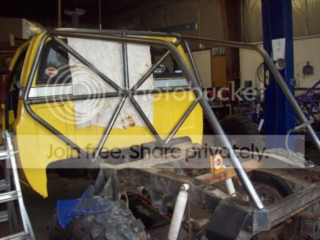

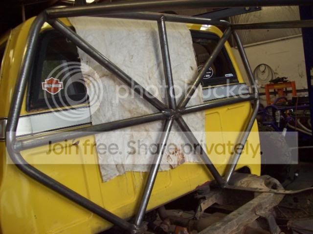

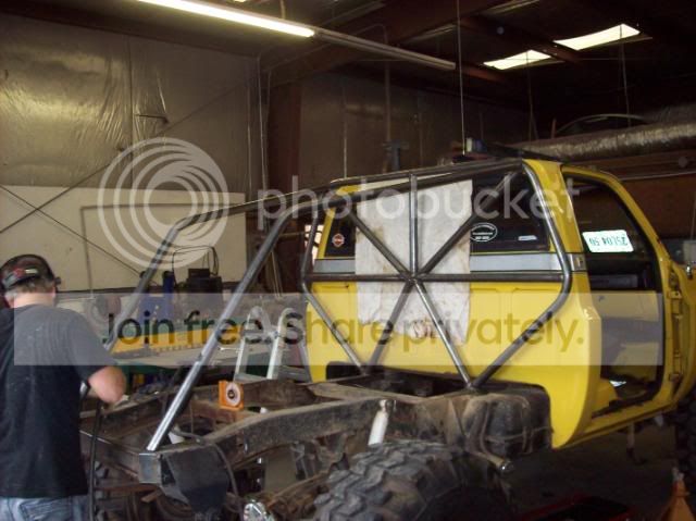

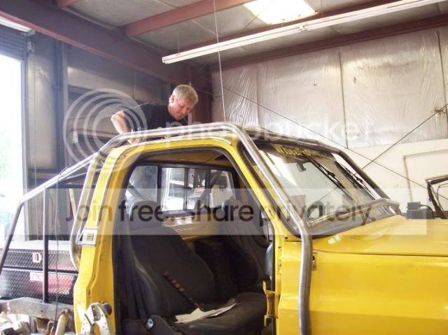

took it wheeling and had tons of problems with the carb alternator and getting used to a stick on the trail...i figured it was time for a cage

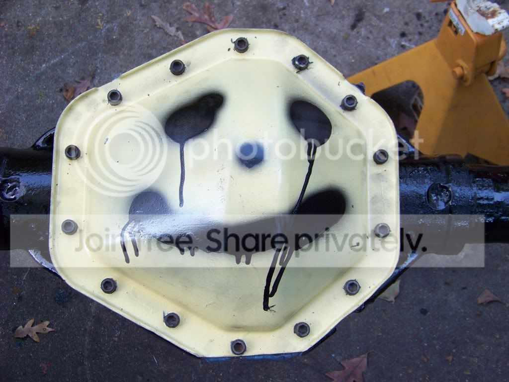

they played a lil joke on me at the shop :rolleyes:
This image has been resized. Click this bar to view the full image. The original image is sized 1024x768.

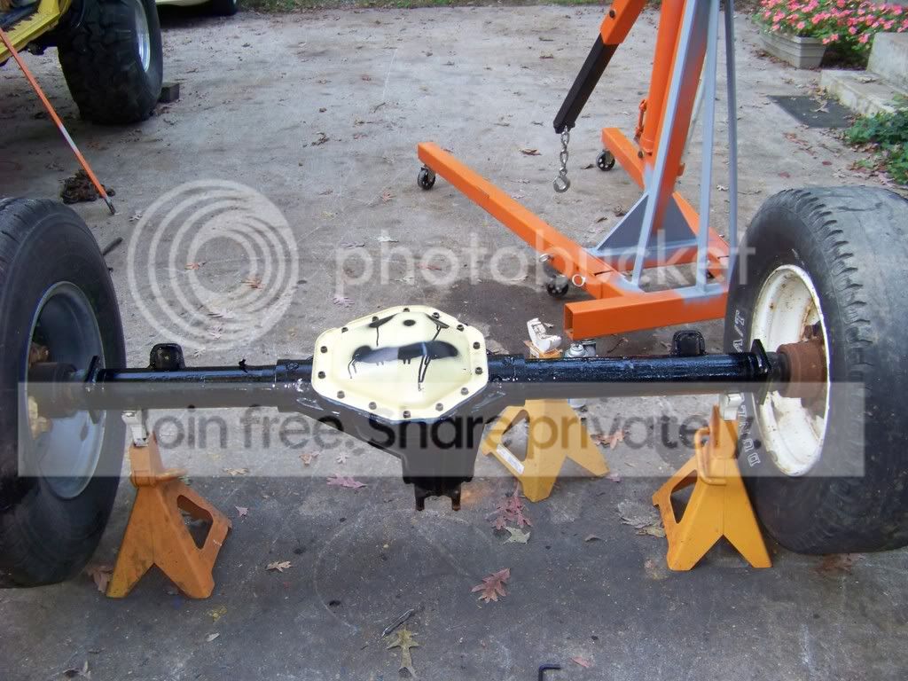

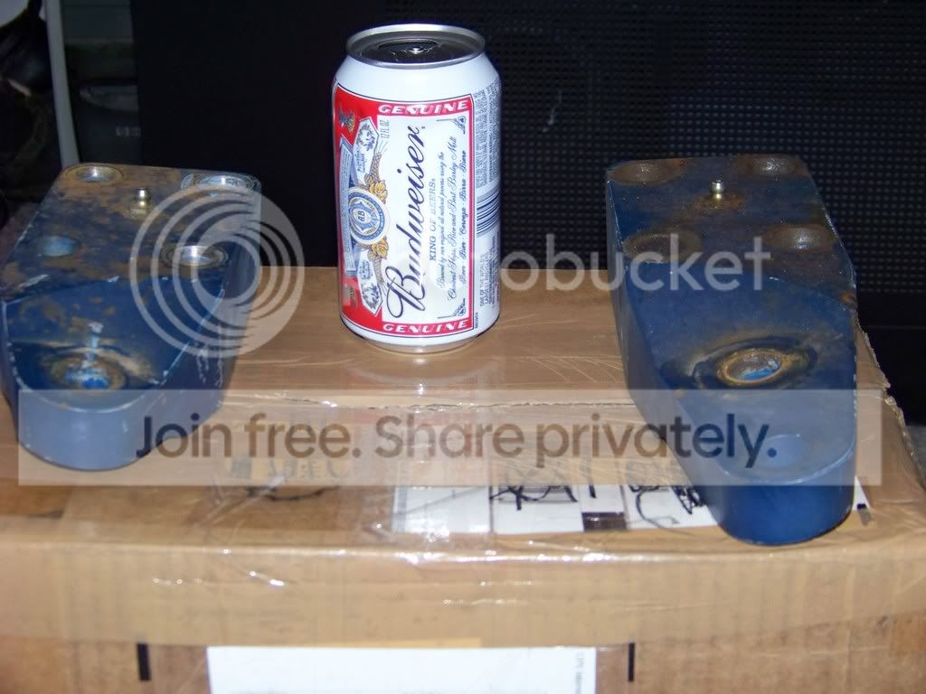

got a 14 bolt 456,detroit and discs (not on yet) thats BRAND NEW no road miles at all from a buddy.shaved it,he already moved the perches and i cut off the shock mounts and painted it

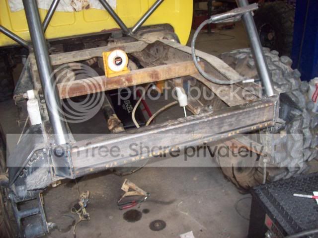

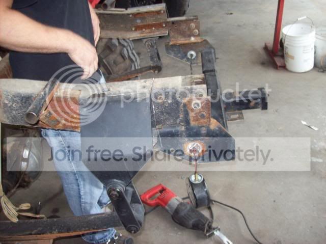

and now the truck is going back in the shop for
boatsiding
4 link rear with 1/4 eliptical
floor boxing
a tcase crossmember
beadlocks
light tabs for 6 lights on the roof and 2 in the back
crossover drag link and tie rod

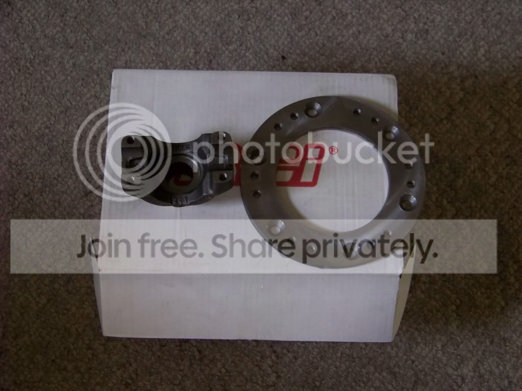

all of my yokes are here all 1410 along with a 208 clocking ring from diy4x

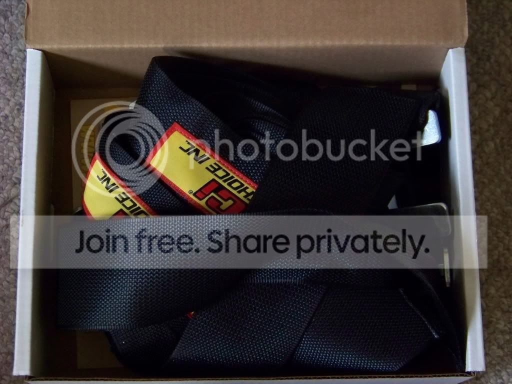

new 5 point harness from rci

my hybrid sye dodge/chevy 208 (thanks john,eric and steve)

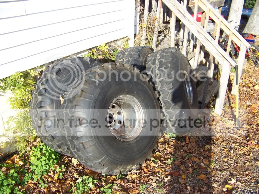

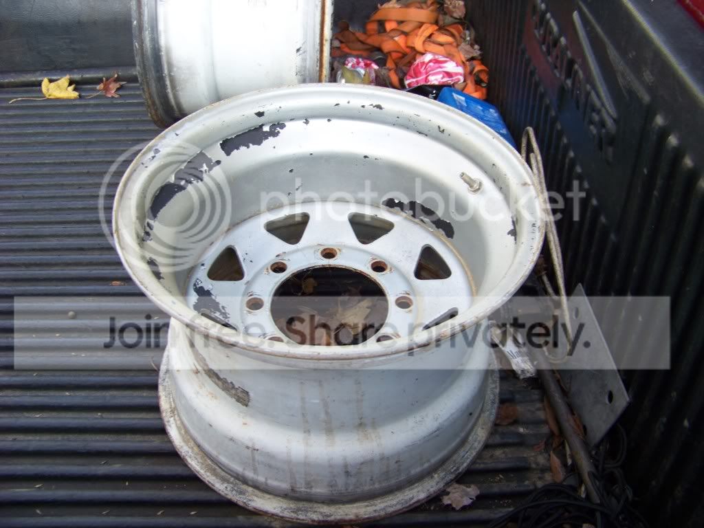

15x10 8 lug wheels that will be getting beadlocks

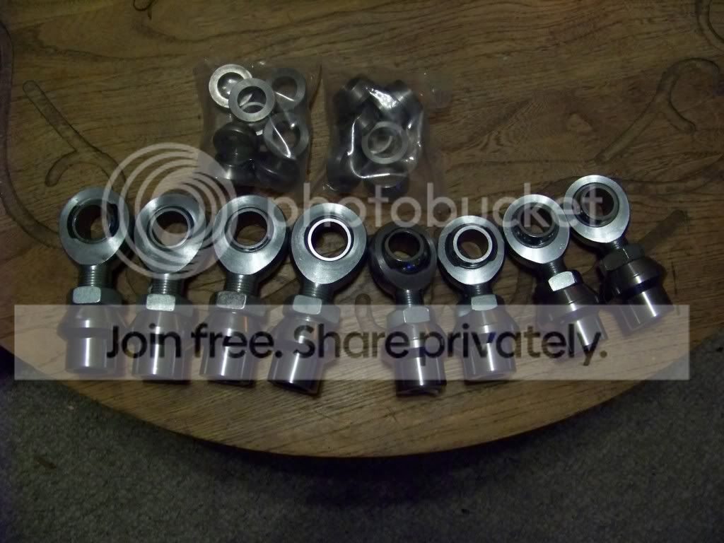

all my heims
16 inch treavel dampaning shocks
at tangent all of my link tubing should be there by now..the link will be made up of 1 3/4 .250 wall dom

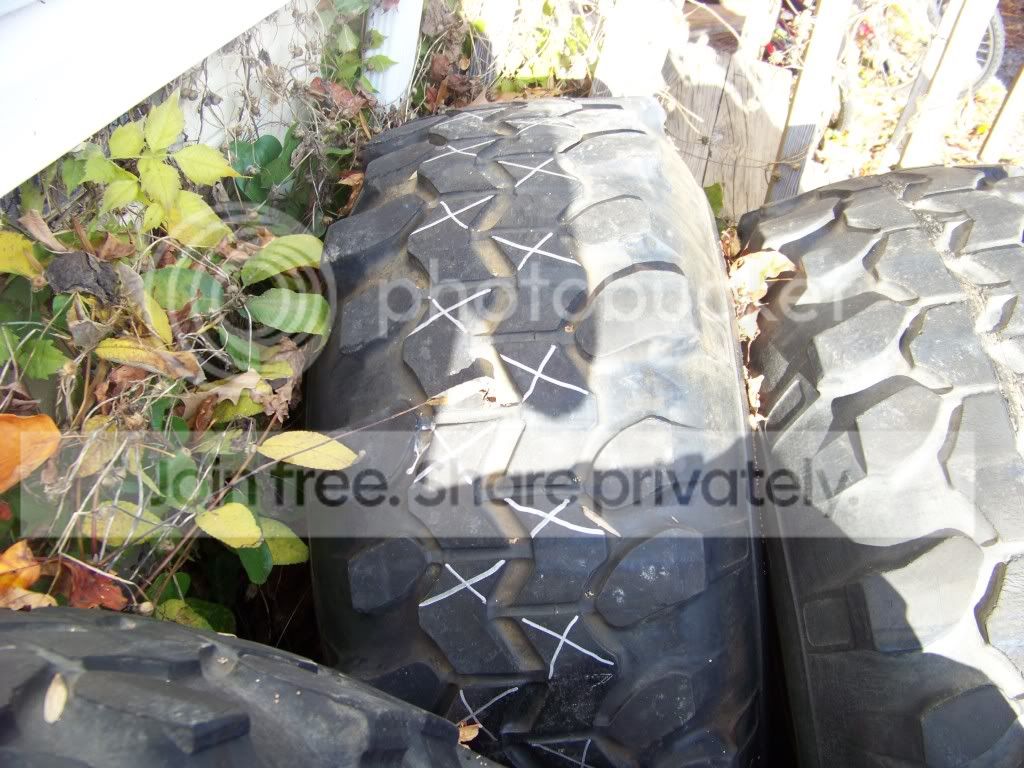

here is my patern ive drawn out for the tires..every x is a lug im gonna remove...prolly just do the rears like this then groove the fronts
looks great, can't wait to see it on phase 2.! on your 208, any better pics? i am in the process of doing one for a blazer/ 62 willy's wagon i'm building for my dad. i have a dodge and a chevy 208 and the problem i ran into was the fluid return passage not lining up between the chevy case half and the dodge sye (the part that holds the bearing) any pics or info would be great.
i have a full right up someone on our site is doing on the whole swap...it was easy we just pulled the tailshaft piece lined up the return and tapped new holes in the chevy back half for the tailshaft...i dont have any more pics right now...i can tell you the (seems like million) snap rings that hold the main shaft in suck!!

i've already done the internals, and x2 on the snap rings sucking, i was kindof stuck on the tailshaft section, but tapping new holes may be the easiest way. i think i was trying to overcomplicate it, and yes it is a easy swap over all. if you have a link to the write up i would like to check it out! thanks for the info. also what size were the swampers you had been running?
the write up isnt done yet...we just tapped the hole with a 3/8 tap its super easy cause its alum. and there is plenty of material there to tap...i was running 39s
