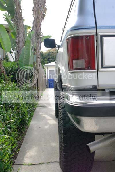

What I am thinking...

The spacer combined with 88-98 brake drum, it works out to be on the money to match the front 10 bolt. 3" wider than rear 10 bolt.
