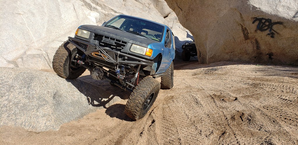

Hey, guys. Thanks for all your help building my axle. It's been a while and my project is finally done. I know it's not a Blazer, but it is a 76 K5 front axle and I hope you guys can appreciate the work anyway.
Well, I'll just focus on the axle and not see the rest!! LOL. Anyways, where are you wheelin in that pic. That looks pretty cool. So much different than what I run up here in Oregon.

Haha yeah, yeah, yeah... I'm in Phoenix, Arizona at a trail called Squeeze Rock. This picture is from right before the entrance to the trail.
