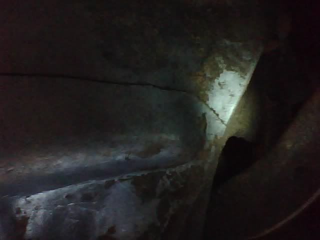

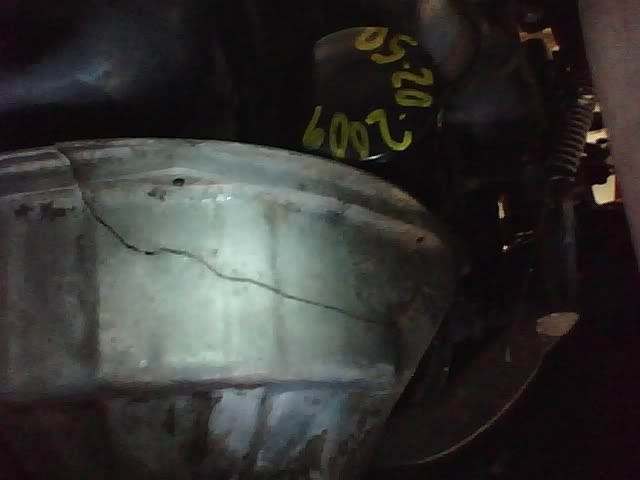

I crawled under my '82 K30 today to change the oil, and found a surprise from this weekend.
It runs from the center of the lower end of the the bellhousing, up to where the clutch fork goes through.
Has anyone ran a Lakewood bellhousing? Does anyone else make another aftermarket bellhousing? I have another stock bellhousing, but I assume I am just going to break it as well. Anyone else have trouble breaking them?
