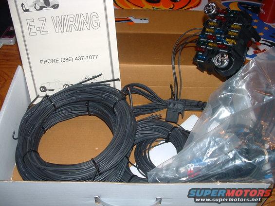

boy that is perdy...
da box
Da contents
WOW... Perdy fuse box and you CAN READ IT!!!!!

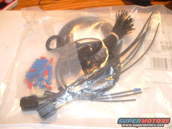

UGHHH how much of this am I going to need?
There is a bypass wire if you have an alt bigger than 80A.... im gonna install my 140A... but not until after the truck is back up and running...
however I will wire it as if it was in though....
