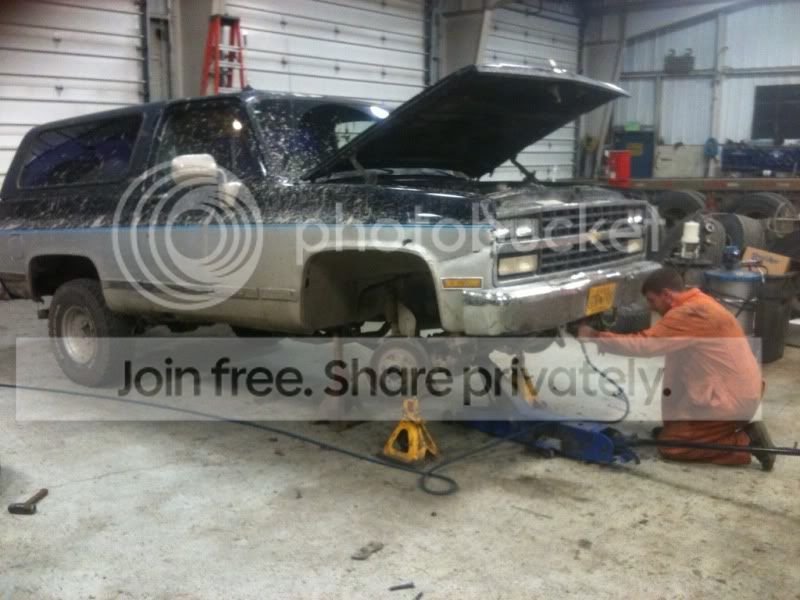

Stock, when I dragged it home.

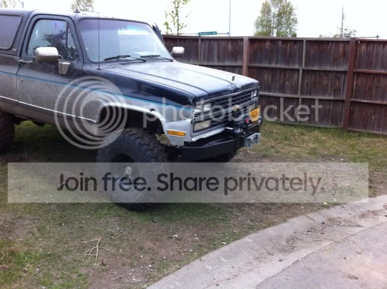

Stock with 33s on 15x8s, trimmed fenders and DIY4X front bumper

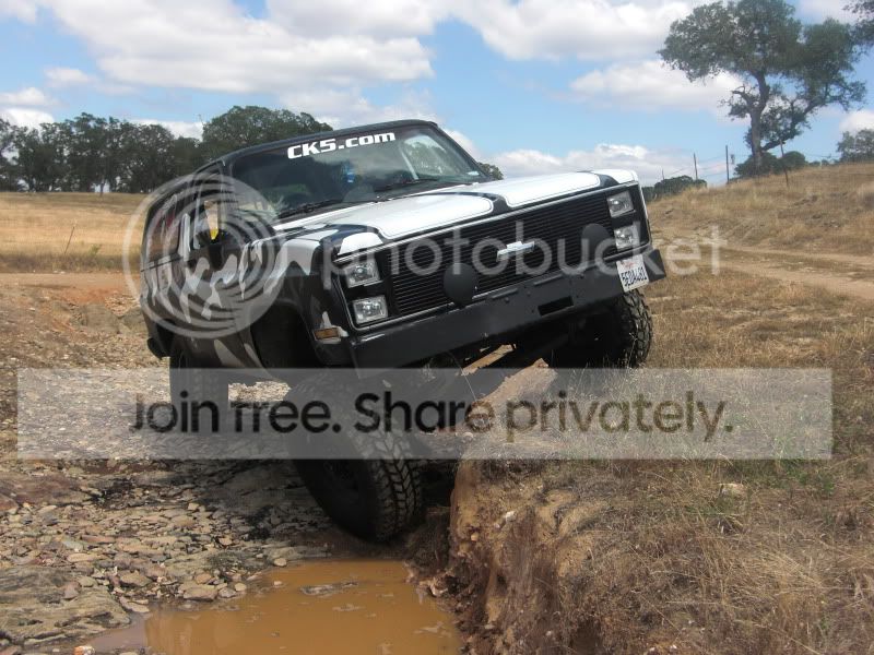

4" lift and 3/4 ton swap on 35s with H2s (cell pic)
Wheeled it a few times

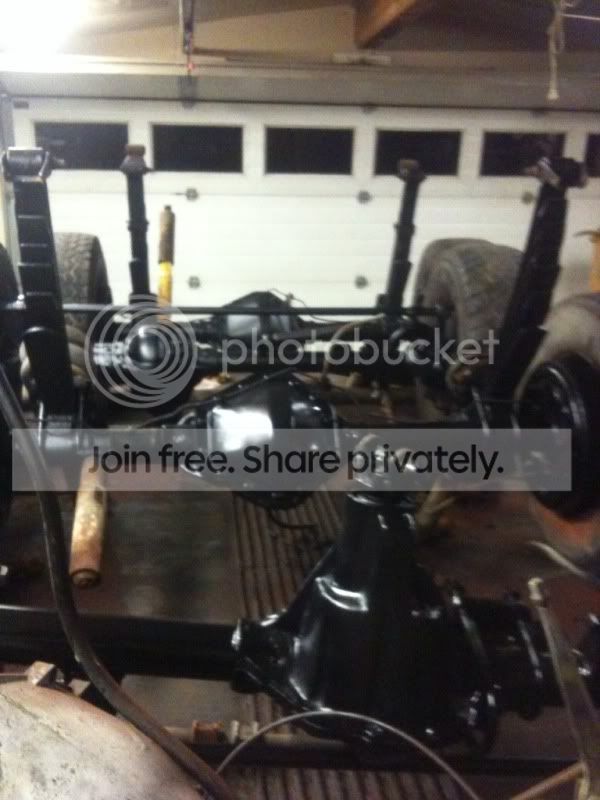

Donor 14ff and d44

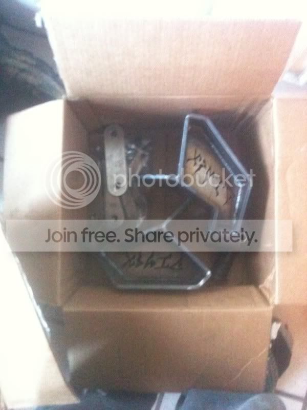

Shackle flip

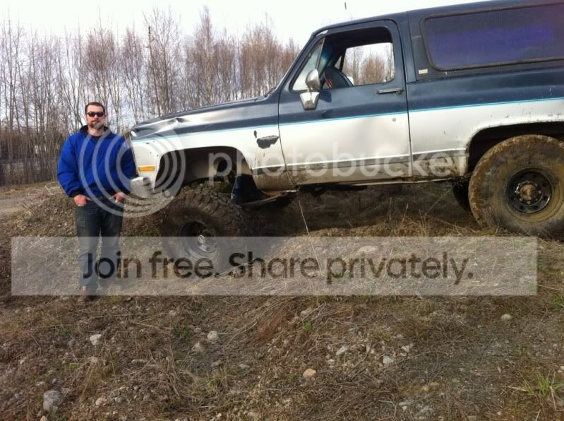

Lift going on
Few shots as of now. Tbi350/r4/241/d44/14b Just got my dana 60 and other 14ff rebuilt and should be going in tomorrow as well as crossover. 4" springs up front with 1" zero rate moved 3/4" forward. Rear, Kerts shackle flip with 7" shackle. Tires are 36x13.5x16 iroc radial. Rims are 16x10 with 4.5 back spacing
