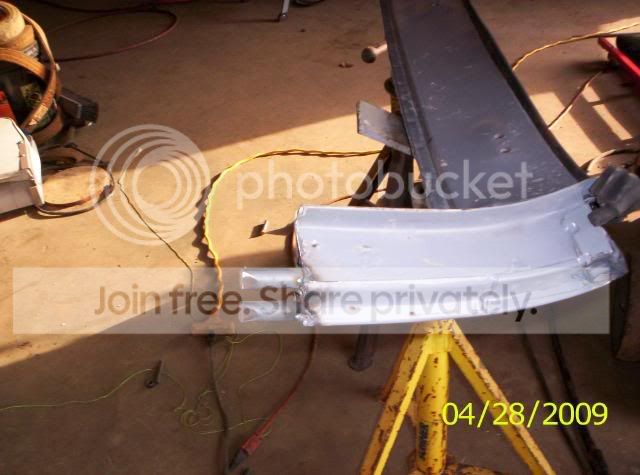

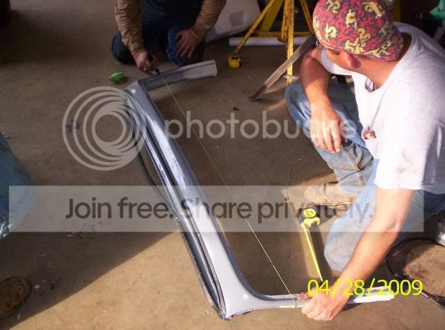

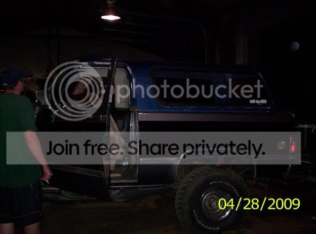

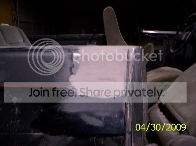

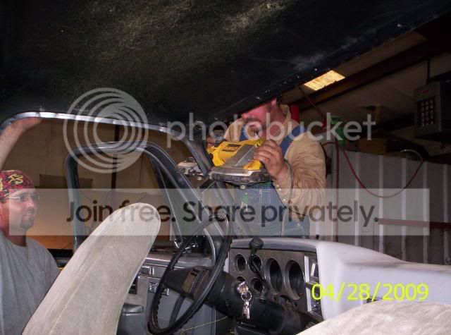

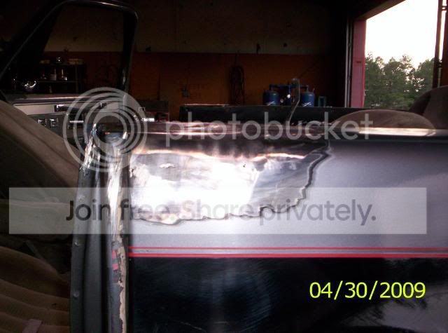

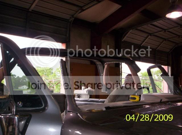

well i chopped and grafted my 86 blazer into a full vert... i need to get some paint work fixed but its ove all a good finished project.... i need all new seals for the top and the doors where is best to buy it?

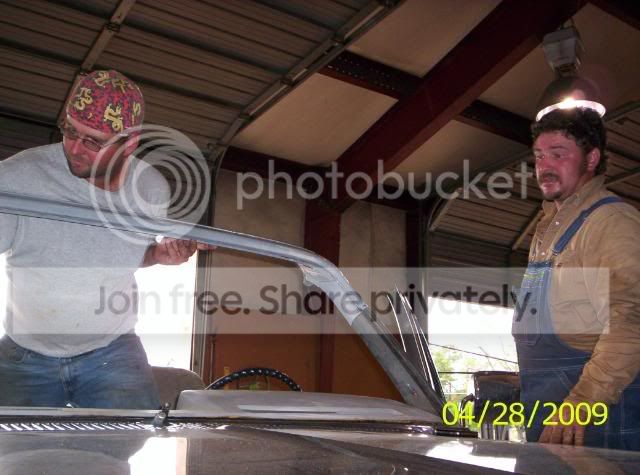

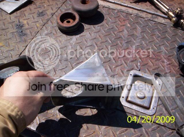

made me some dial pins to help reinforce the frame and help line up

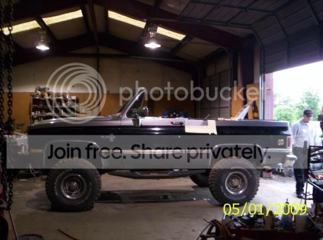

we got her tacked up and the top sittin on it to make sure all lined up and TADA!

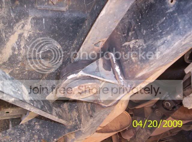

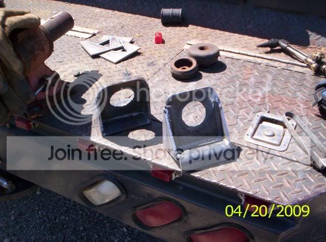

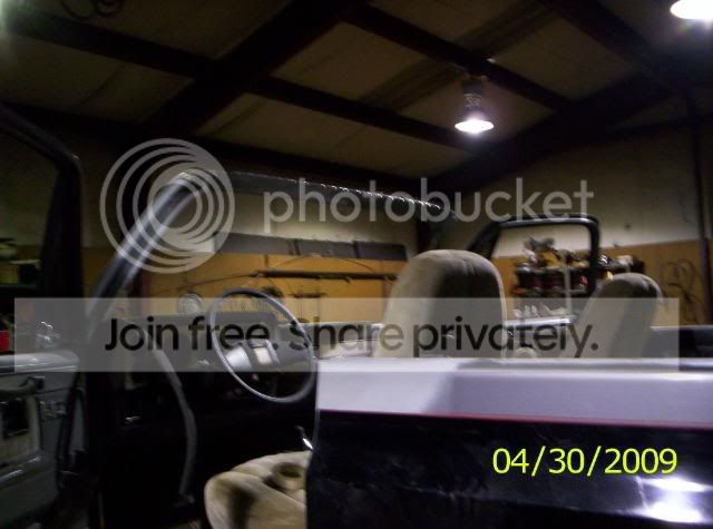

and no body sag yet. i made some extra body mounts to help hold the cab up
welded to the frame
Just a FYI regarding body sag...it isn't the body itself that sags and moves, it's the firewall/cowl that moves back and forth. Best method is actually a couple of engine bay cage tubes tied to the firewall and then down to the front frame area. Typically the weight of the doors wants to pull the firewall back over time, or under the stress of wheeling.
I could move mine forward over 1/2" by hand from inside the truck.
Rene
a good cage would help also to sturdy up the body.and also keep you and the occupants safe.looks real good.im glad mine started as a full vert.i like your alligning pin idea to help line it up.good work.
Rene
thanks man i am thinkin bout a cage but i had enough fab for a day or so.... most wheelin i may do is cross a ditch in the yard or goin to feed the cows... mostly flexin out on the local mall fountain... 6" curbs are a little tricky to climb
You could even just run some diagonal bars down to the front frame area from the firewall. Where it gets a bit annoying is when your doors don't close quite right anymore, and the hardtop doesn't seal like it should.
A cage with full vert is definitely a good plan though...imagine if you flopped it going over one of those 6" curbs? ;)
Rene
Rene
could cut a 35" on those kinda angles good point
You could even just run some diagonal bars down to the front frame area from the firewall. Rene
that is a good idea i will look into that cause i aint really wanting a full on cage i got the original roll bar out of the 75 but i gonna mod it to fit floor pans aint same
