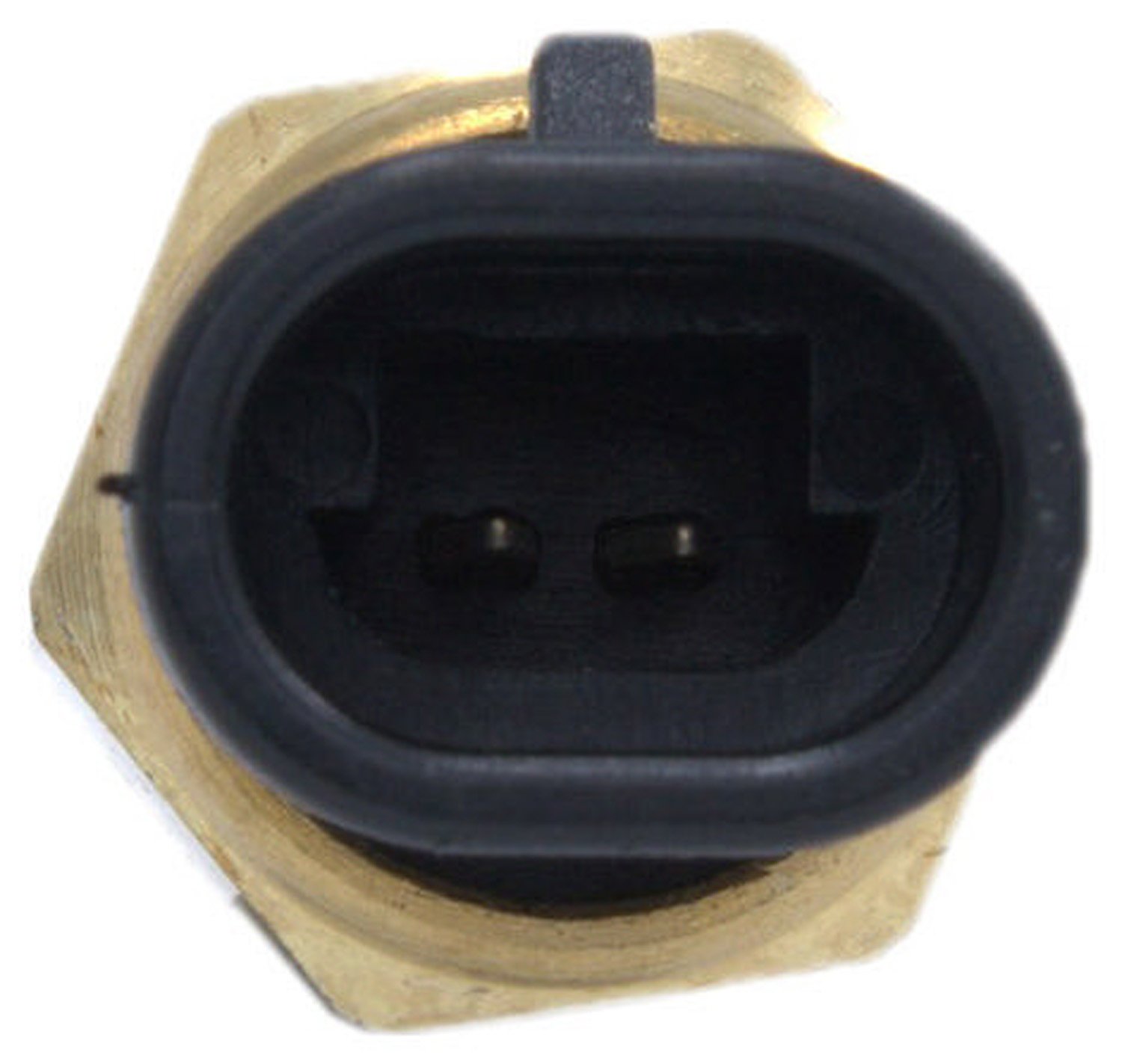

Looking to replace my coolant temp sensor in the intake manifold on my 87 K5 TBI motor.
Anyone know correct AC Delco part # to order?
Coming up with multi #'s. Thanks in advance!
I know it's a bit of a pain, but go to the link in my sig, download the parts and illustration catalogs that cover your year, look up the GM Part number, then cross reference.
Buddy has been replacing engine components in his '91 Suburban, and finding that the aftermarket is all screwed up on their part numbers. Best to use the GM PN to cross reference, and normally, unless the part number was superseded, best to look elsewhere when two different GM PN's are referenced as being replaced by the same aftermarket piece. AFAIK for '87 there should be only one temp sensor. Sensor has two wires, sender has one.
AC DELCO 15-51107 OR 19189478. The one in my 1990 manifold just says AC 12 V looks just like the one on Amazon
