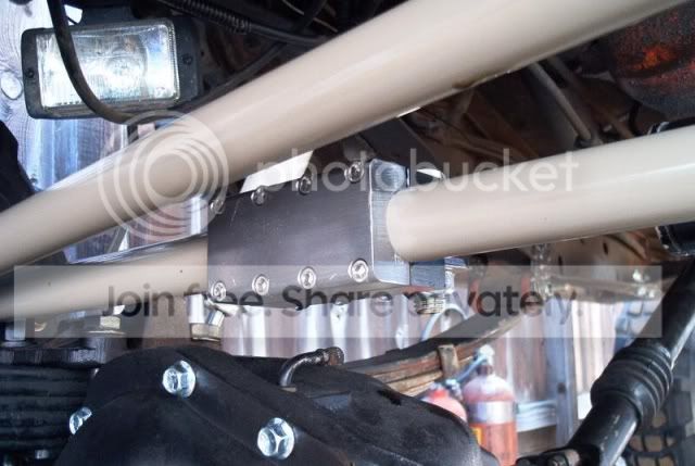

I don't know about anyone offering something for sale, but the solution is dead-simple.....
Here's what I did:
I just utilizes the large swaybar bolt as an anchor, and one of the u-bolts to clamp it down. Works great and it's simple.
Here's a shot installed:

I like it. Is your axle relocated with 52/56's or is it in the stock location?

The front springpin re-locates the axle 1" forward from stock.
45" overall length IIRC..... It's a 1st Gen thing. :D

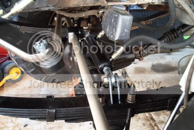

Waaay old pics,but Im still running the same setup :p:
I cant remember exactly what Gregs looks like but I got my idea from him :D
My ram mount clamp :D

Even though I already bought the 1/2 inch plate to make these I went ahead an ordered new 1/2 u-bolt plates from ruffstuff today.For the 50 bucks I figured I would rather work a hour more than build em and aggravate myself.
Ill just add my tabs and use a ballistic tube clamp I have.
