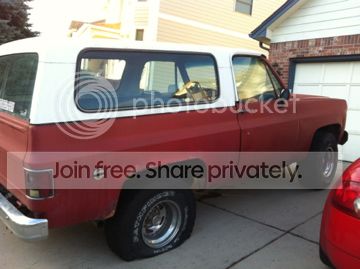

Here she is ...test pic
More pics to follow this weekend. Took a bit longer than I thought to make the deal. As you can see, there is rust in the rear bedside panel. The night I got her home I took out the seats and all carpet to really give her the once over. No rust issues some of these trucks have other than the rear panels. The truck appears to be unmolested by PO's. There's no lift, no after market upgrades. Appears to be stock for the most part.

Your doors are sagging. May need new bushings for the hinges or new hinges. I just found out that the bushing from factory was nylon. When I tried to change mine, the pins wore through the bushing into the hinge. I going to have to go through whatever hinges I have to see if I can make a good set.
Check to see if there is any cracks on the door where the hinges mount.
The striker post have a tendency to crack also when the striker post bushing wears out.

Interesting that you can see that just by looking at this photo.:bow: I believe you though. I'll look at that first thing this evening.
edit: went ahead and reserved two kits at my local autozone. Thanks for the feedback.
