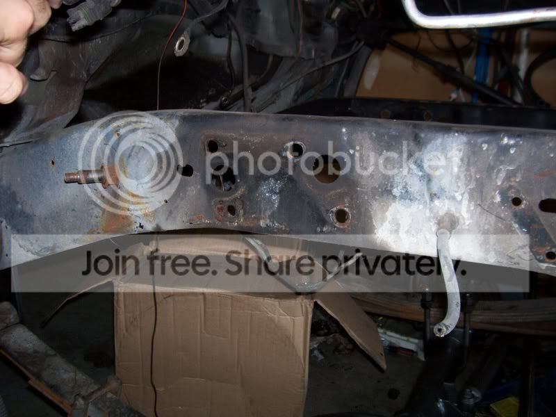

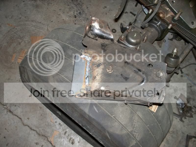

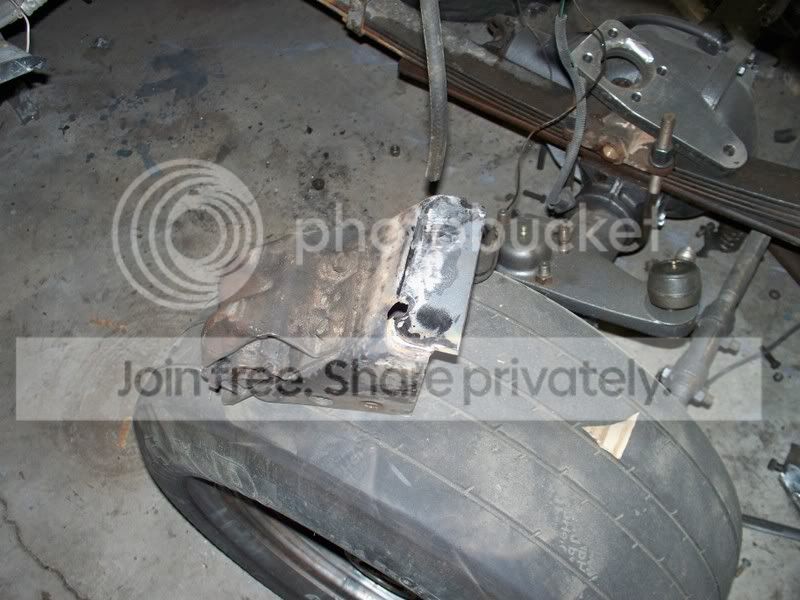

The 2wd frame is a little shorter so I cut the top off and rewelded another on.
I only have one mount so I need to find another one :doah:

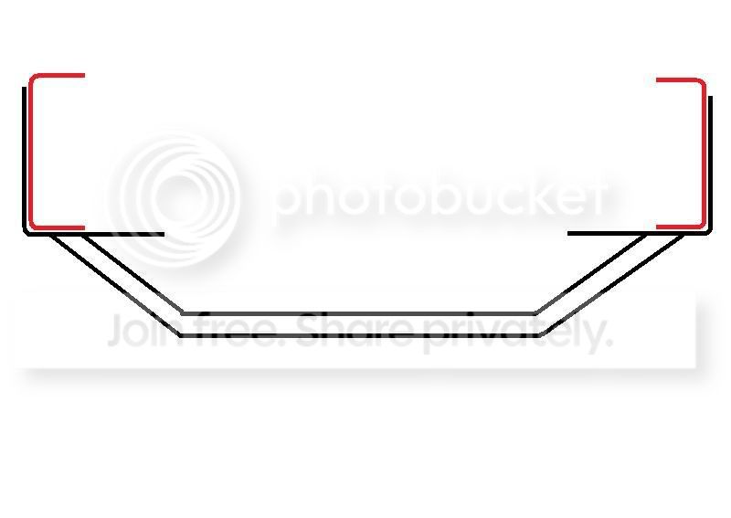

And the engine mount should be something like this
But with the tabs going to the brackets of course
Looks almost like the panhard/crossmember that dcubb makes.
I'm pretty much going off of that design. Seems like a good idea.

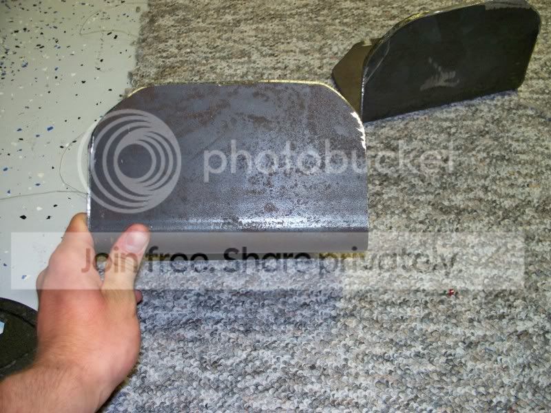

I'm also going to put my shock mounts of the 90* sides also

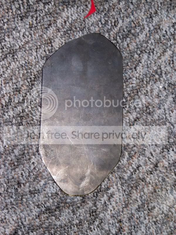

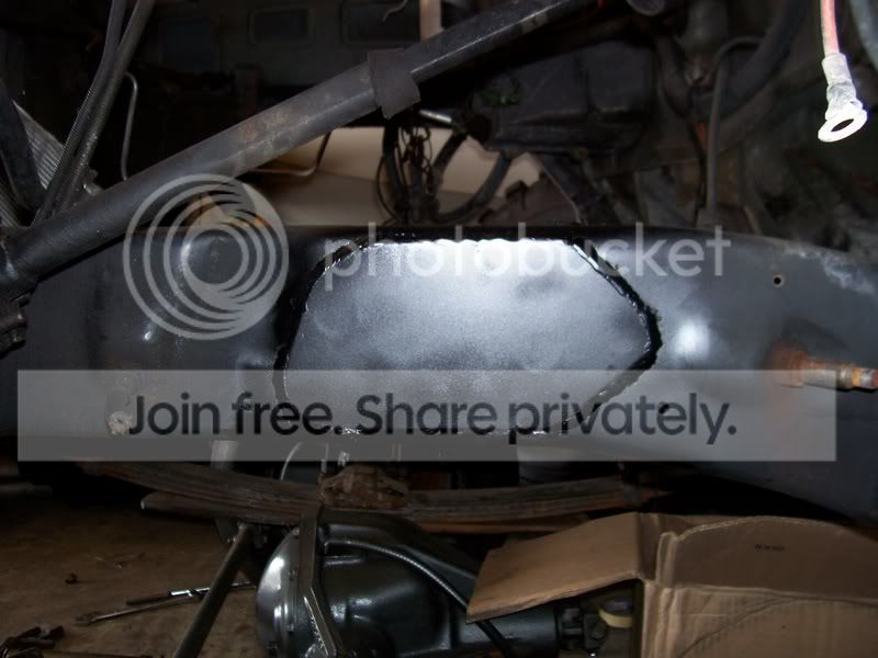

I plated the frame where the holes for the 2wd stuff is also, this is where I'm going to bolt it through.
Heres his, looks great
Do you have a shot of the side frame before you plated it? Just curious to see what a 2wd frame looks like without all the suspension crap bolted on it.

whats the little tabs sticking up w/2 holes for? i'm curious b/c i maybe about to convert a 2wd to a 4x(depends on if i get the 74 k5 or not), but i will be converting a 87 cc and i've read that all cc are on 1 ton frames even the 3/4 ton cc, is this true?

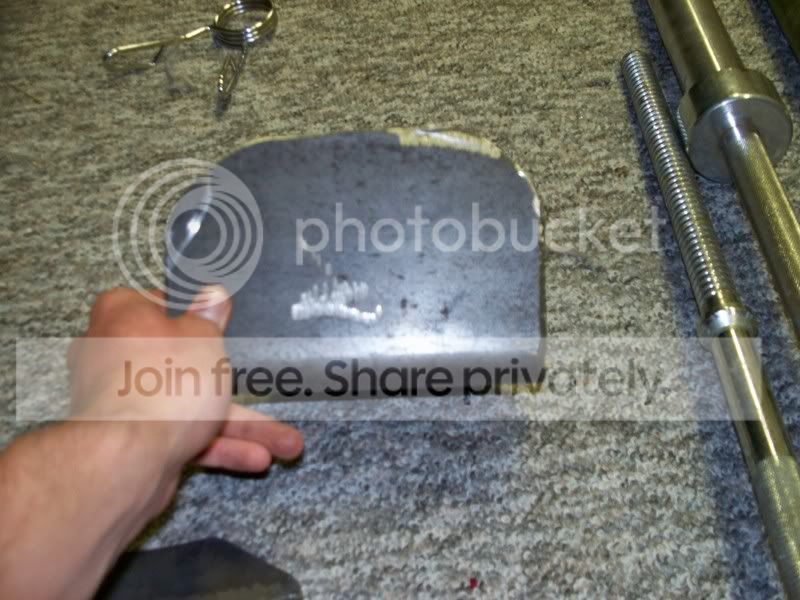

Heres the two 90* pieces, I cut it out of a piece of rectangular tubing so the edges would be smoother. Also the other fish plate. I round the edges so they look better.
I have a stick of I think 3 1/2 by 1 1/2 3/16 wall tubing also for the part that goes across.
