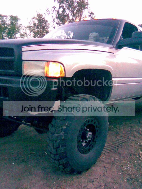

My Dodge has NO problem wearing any tire out fast. Too much weigh, too much power. BUT it's a fun truck! :eek1::D
Jimbo, do you know if there are civvy street or A/T-tread medium duty tires, say 7.50-20 that will fit the donk bead?
I was thinking about running SRW 19.5s on my Dodge, but the wheels and tires are $$$!
Dude, that thing is gnarly!
