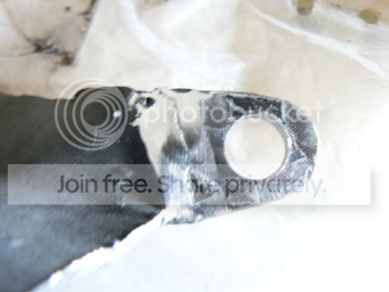

I got my electric fans in and Blue Torch Fab diff covers on. I screwed those covers up when I welded them up. Too much heat and slight warpage. :doah: Garage fix and no leaks.

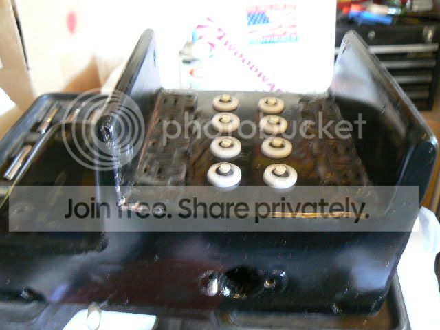

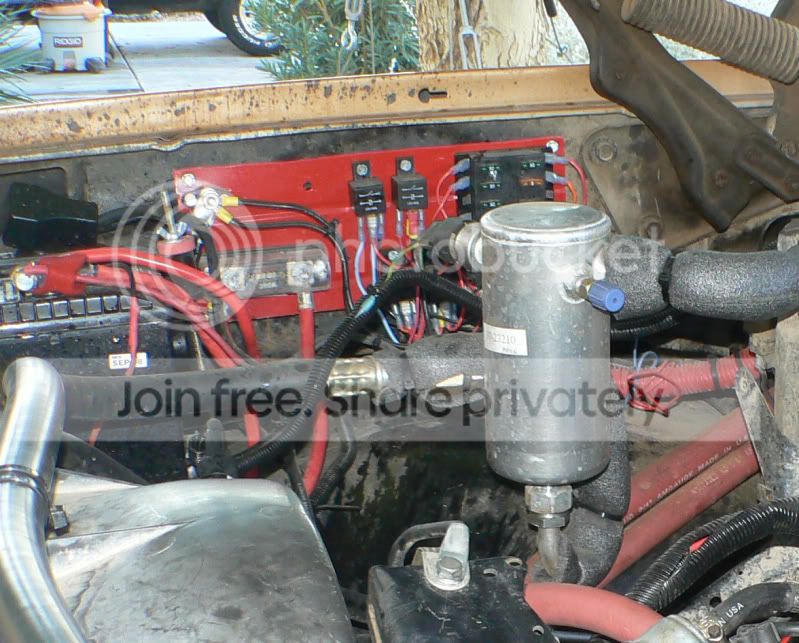

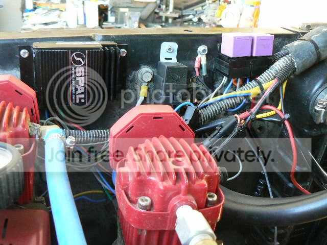

I installed my pusher fan for the AC and extra relay. The extra relay turns off the pusher fan when the cooling fans turn on high.

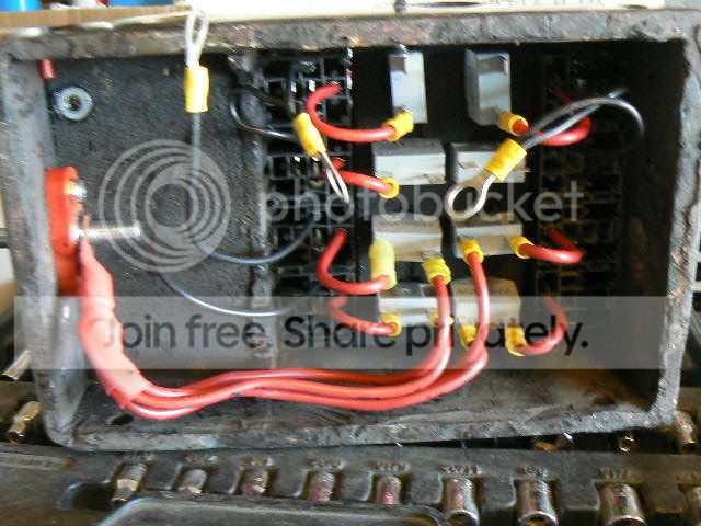

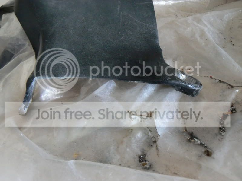

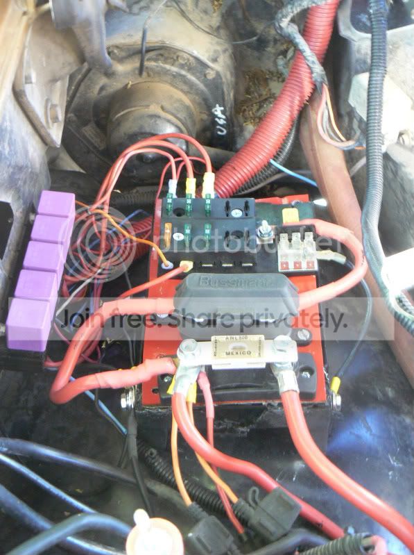

I changed my electrical setup as while I was at it. I put a 500A fuse on my winch. A 150A fuse for the accessories
I went from this:
To This:

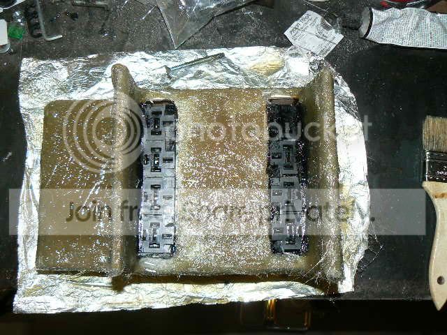

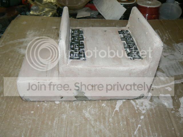

I tried to do a fiberglass enclosure with circuit breakers. It was great in theory, but I didn't plan the space to well. The existing wires were a little too short to run them in and mount it up. First attempt at fiberglass:

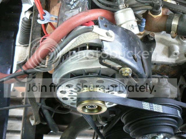

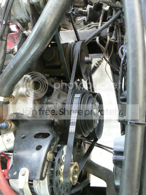

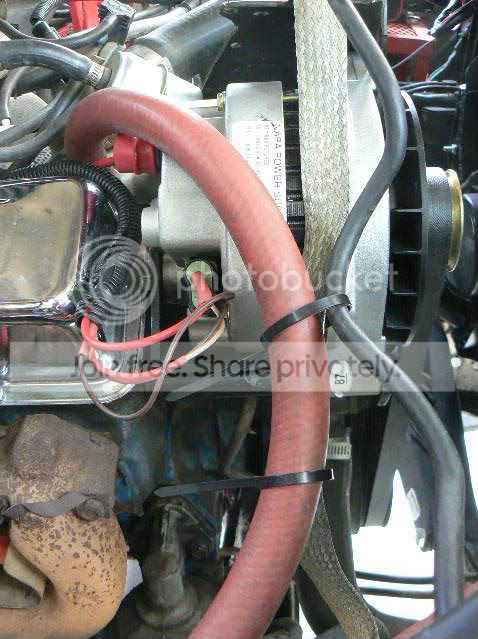

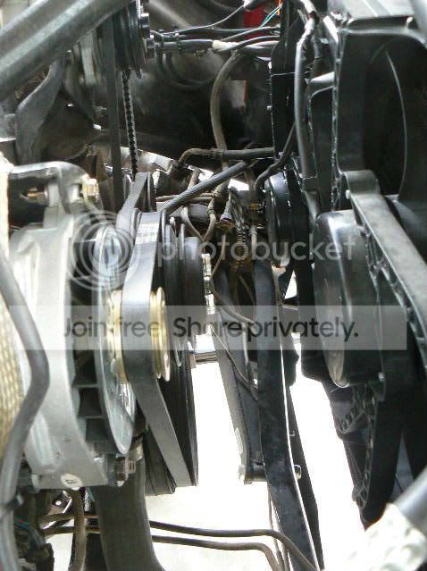

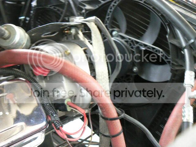

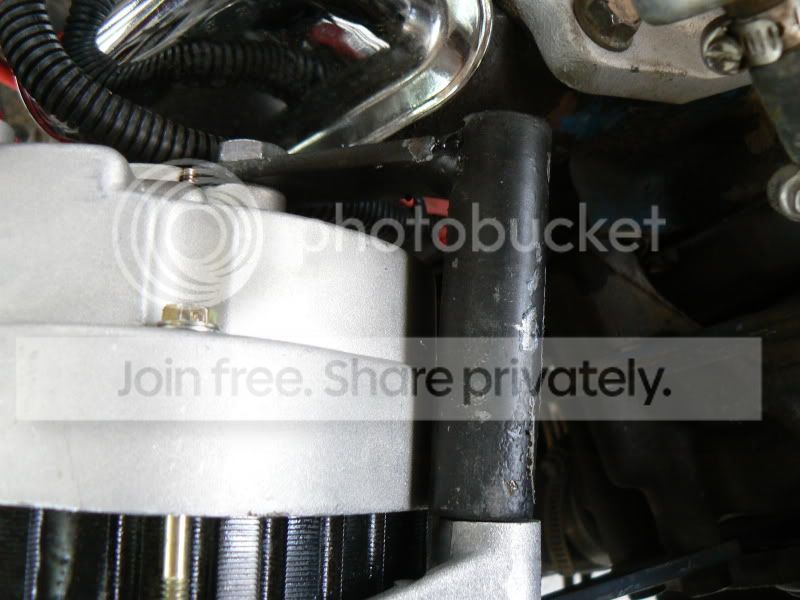

I also swapped my 94A alternator to the CS144. I upgraded to 8ga wiring and a semi-serpentine set-up from an 86 Monte Carlo.
I cut the vertical tab that bolts to the water pump and welded up a longer piece to raise it up. I also welded a small 1/4" thick metal to the horizontal tab that bolts to the intake.
I used a grade 8 bolt rather than trying to open up the bracket slot. It seems to be working OK.
I also fabbed up the rear bracket and bolted it to the center bolt of the rear of the CS144.
The semi-serpentine belt gives me one more belt possibility. I may install either a york compressor or a welding alternator in the center.
I still have to swap out the pulley on the alternator to a 5 spline pulley.

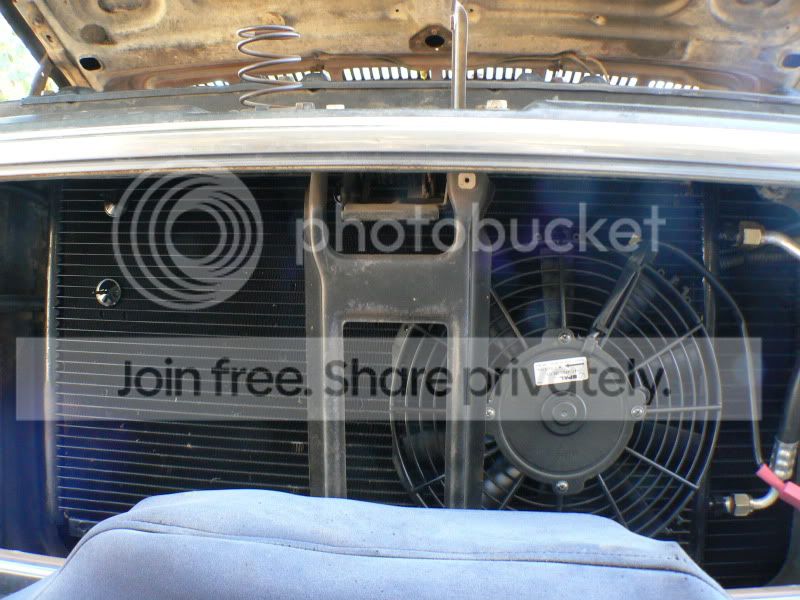

hey do you mind posting some pics of how your ac rad mounts to the rad support? i'm putting ac in my 77 blazer tht didn't have it before (crazy, i know) and i'd just like some reference cuz i've only worked on 80's trucks before and things aren't as easy to switch over as i thought.
I think I have some around. If not I'll take a couple and post up. Give me a day or two.
Here you go.
This one is a little blurry - best I have.
I used a hole saw and drilled out rubber bushings from an old tire to limit the vibration on the condenser. Each mounting point on the condenser has one bushing.

I had room in between the radiator and condenser to put the tranny cooler.

New wiring / power distribution

Built a custom grill - by the way - I suck at welding aluminum.
