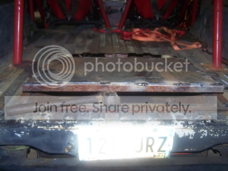

My tool box. I think its cool.
clarkjw24
Dec 4, 2003
3,529
5
McBee, SC 29101

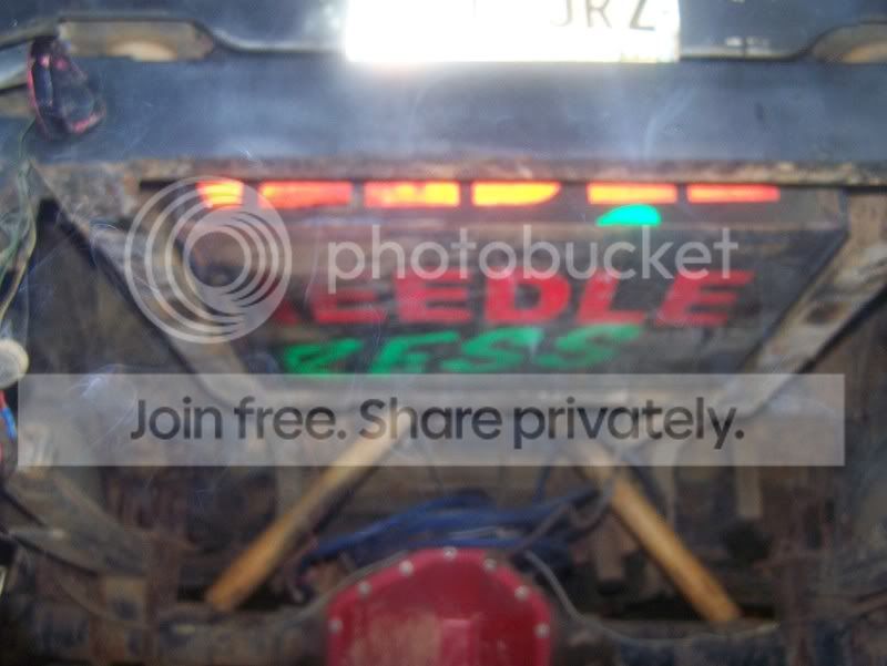

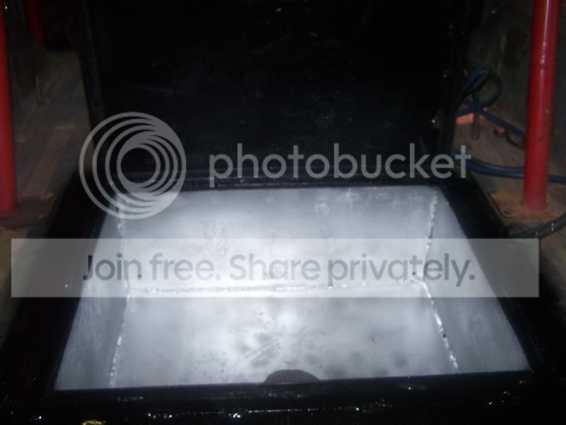

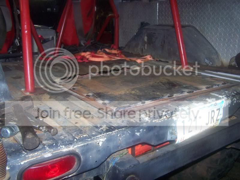

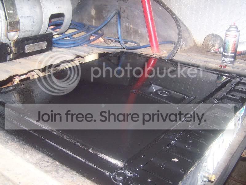

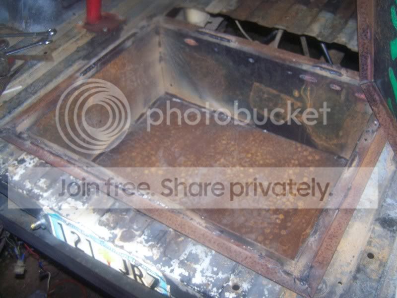

So years ago I moved the gas tank into the bed by cutting a hole. I kept slamming it on rocks so it had to go up. Then recently I converted to propane, so now I had a huge hole in the bed. This is what I came up with. Still got to mount the tanks and rear seats but I think its going to work out nicely. The box is 27x22x10 and its flush with the bottom of the frame rails.
Trail box, ready and packed.

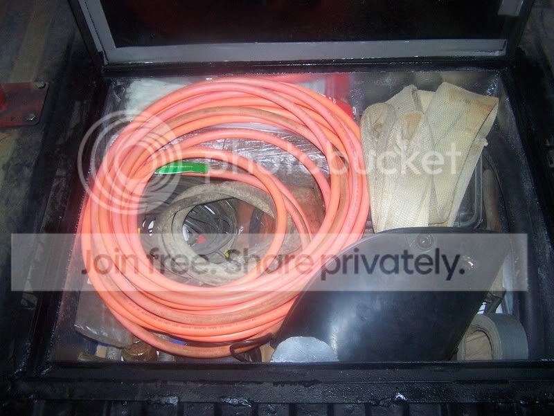

Box contains, extra ujoints, misc heater, vac, hydraulic, pane hoses, 2x 18ft of welding lead, box of welding rods, welding helmet, ratches, sockets, wrenches, screw drivers, duct tape, zip ties, 50ft air hose, impact gun, tire chuck, tire gauge, easy outs, crow bars, shovel, axe/pick, misc fittings for pane and hydro, snatch block, tree savers, shackles, winch controller, germx wipes and some other junk. I need to pack a BFH, pair of gloves and couple quarts of fluids but I think it will all fit.
What keeps the water out??
Btw i like it. thought of the same thing on my blazer but i'd have move my tank to god knows where :rolleyes:
The way I made the lid, it has a channel to sit in. Any water would run into the channel then out to the ground through the drain holes. I used 2 pieces of 1" angle turned like this -\_/ and the lid sits in that around the "outside" of the box. BTW this is in my K5.
