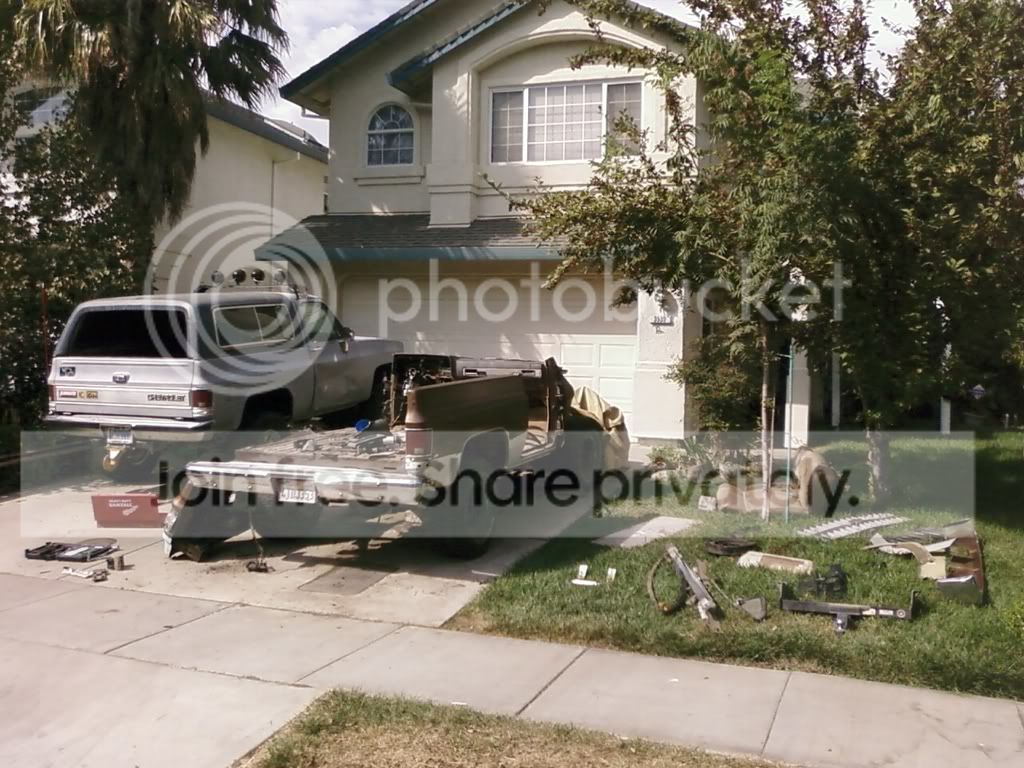

well i have had this blazer parked in my driveway for about a year the tranny blew and now ive decided to do something cool with it so here goes
i started cutting the body off and looking for a pickup
well i found the pickup its a 82 k20 has a 14 bolt rear and a crappy 10 bolt front but it also has an sm465 and np205 so im happy i took it home for 250 it had a front clip and doors when i brought it home but i scrapped em cause the doors were holey and im putting a square style front clip on it

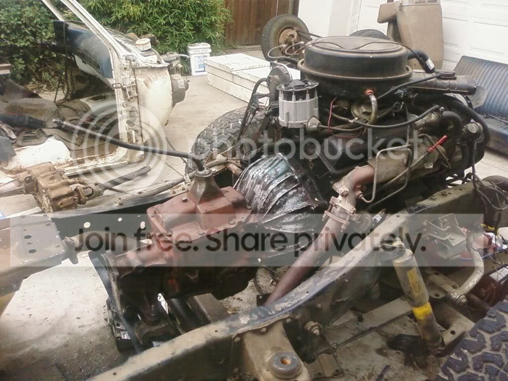

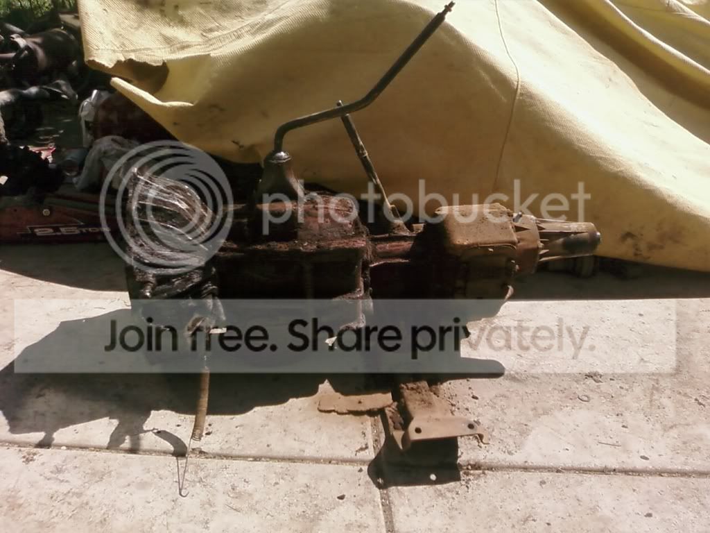

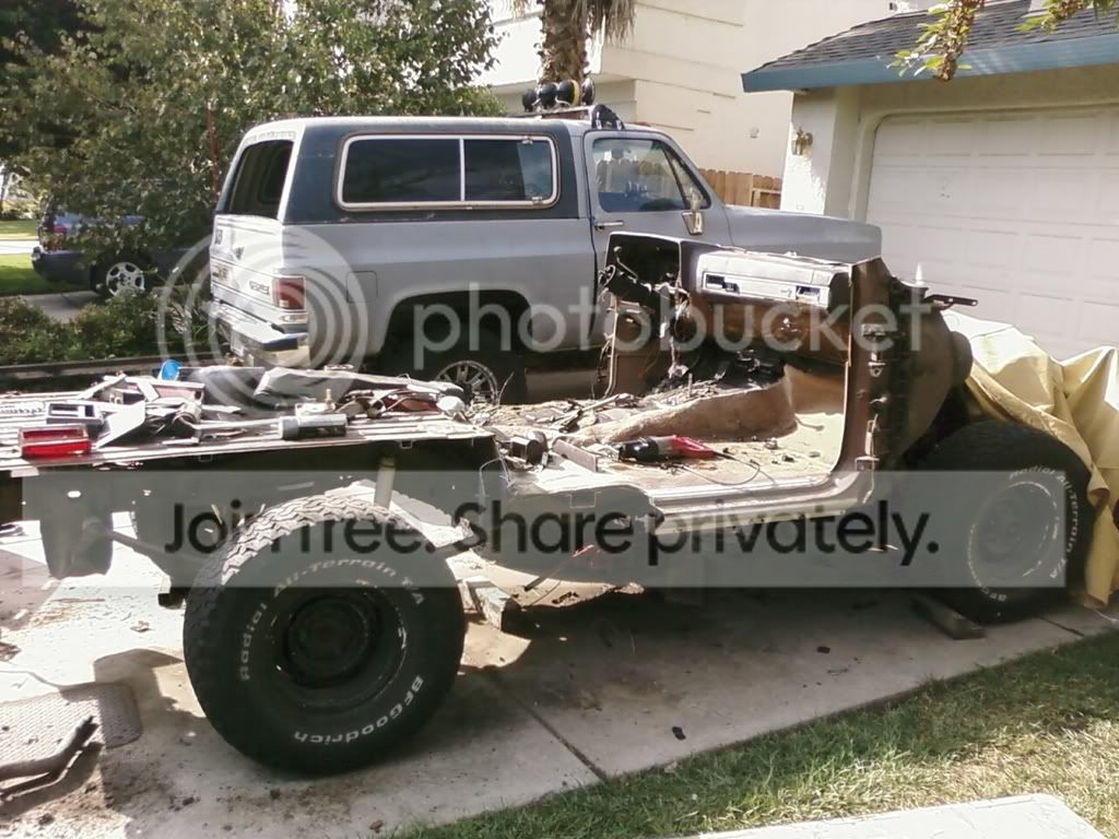

well i got the cab off and scrapped the pickup frame all i need is a clutch and flywheel then i can put this between the rails of the blazer frame
im gunna rebuild the 205 and im also going to convert it to fixed yoke. after i get the tranny bolted to the engine the cab will go on the blazer frame and ill go ahead and make the rear cab mount.

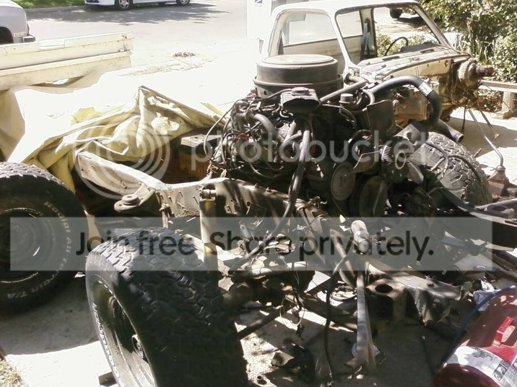

heres the blazer chassis its a 4 barrel 350 im kinda worried ill have troube smogging the trazer because the pickup had 2 barrel carb but we will see what happens if anyone here knows what may happe with that let me know ill keep yall updated
well ive been working on it a little the past week its been slow because ive had to wait for a clutch and flywheel from the auto parts store and now i have to wait longer because i had to order the flywheel bolts since i switched from automatic to manual on the blazer chassis the bolts are different length also i need the bolts that hold the clutch onto the flywheel would i be okay just using some grade 8 bolts from ace? thanks
wow, you must have sucky auto parts stores around you to not have an old chevy clutch setup in stock.
i got my flywheel to crank bolts from summit, they ship quick, and just used grade 8 bolts for the clutch to the flywheel.

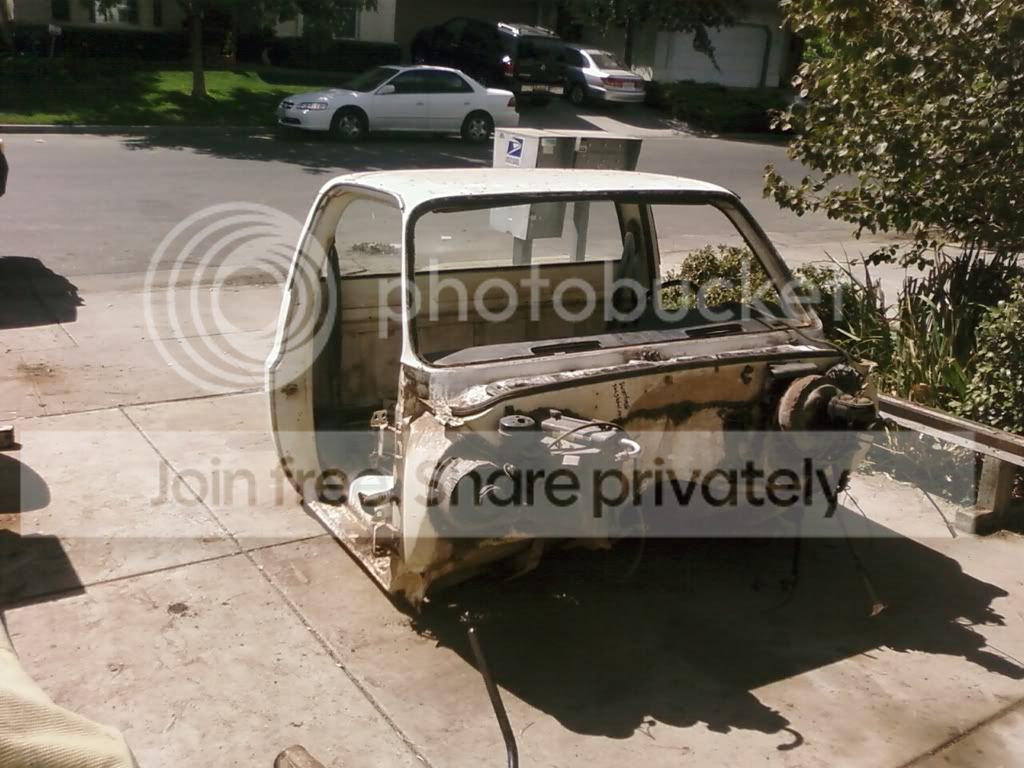

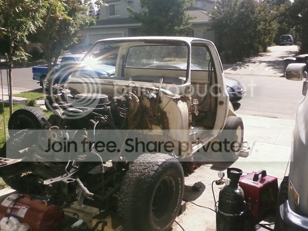

well i got some crap done today the clutch is in the tranny is in and i put the new crossmember in the next thing is the cab ill have more pics tomorrow

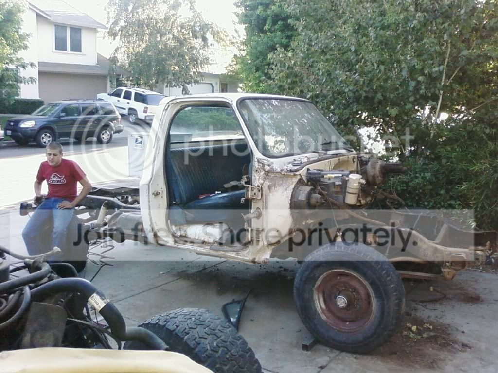

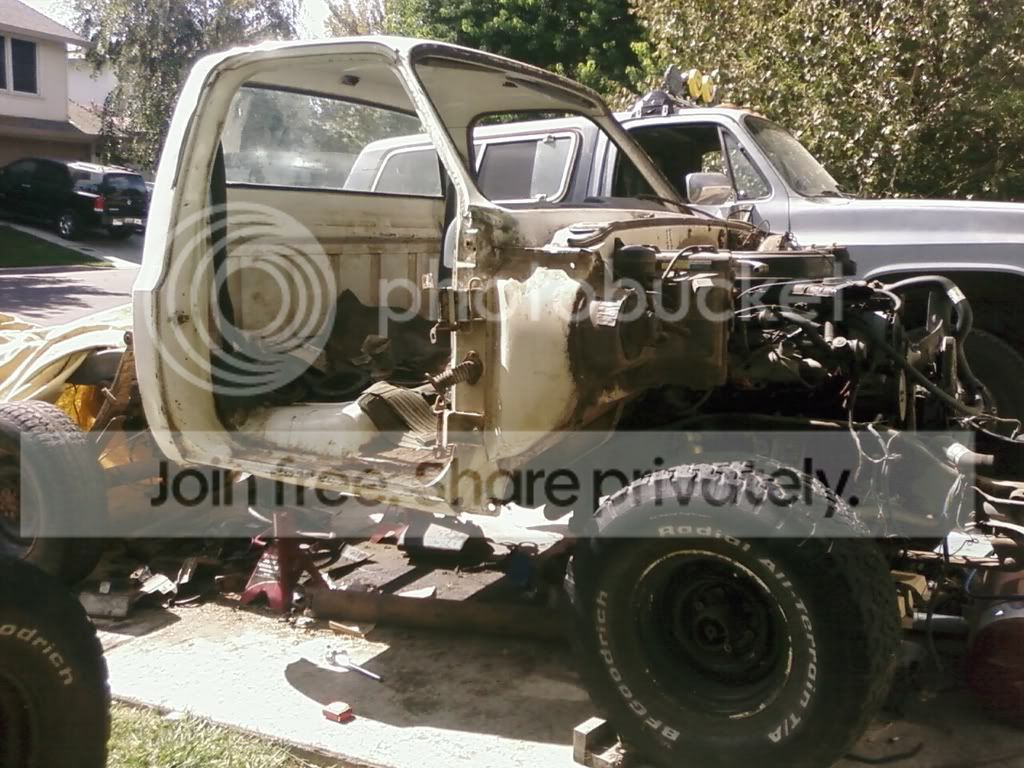

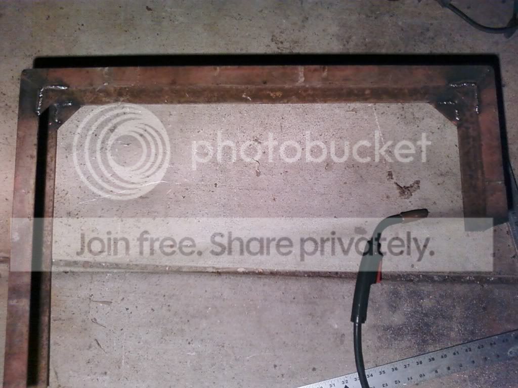

got the cab on and started making the rear cab support just need to cut the feet to right length and put holes in it for the bushings
this is the rear cab support if anyone is confused
