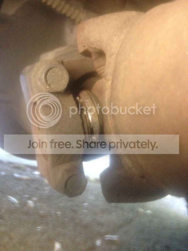

That is a bad u-joint. From the looks of that front one it is an original still. I would recommend changing all the u-joint in that rear shaft and i'll bet at least one of them come apart all dry and rusty dust.
20 sec in to it .
time for a pair of u-joints. if you drop the shaft to replace 1 best just do both.
you will find dry grease in prob 3 caps. and 4th will be none and chewed up needles and severe grinding spots on the cross were the cap/needles goes.
the bell/ding is the bad cap with no grease and chewed markes grinding its self apart and it echo's in the drive shaft tube like a MEGA PHONE :ears:
Go tap the driveshaft with a tool and you will hear that same tone. The only question is what's exciting it. Probably a bad U-joint, like posted above.

after further inspection this is what I found...

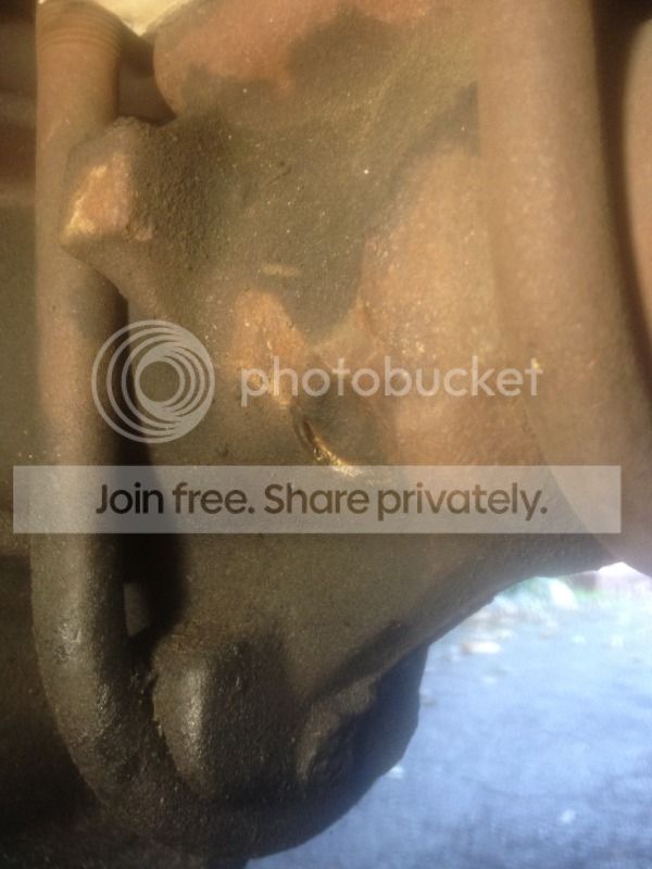

I also saw this on the front diff.. is it serious?

also thats a plug weld from the factory . its normal.
So the U-joint is fragged. No biggie-just replace it. Unless you've made some other mods, there's no need for a new driveshaft. If you want it to be quick, a shop should only charge an hour for that job. But this is CK5 and we'll all tell you it's a basic maintenance item you should learn to do at home.

As for the front end, what are you concerned about? The plug weld? I don't see anything concerning.
