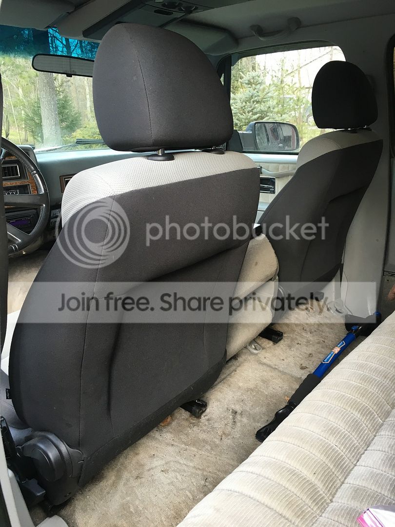

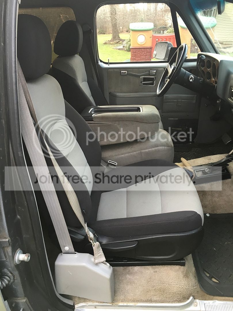

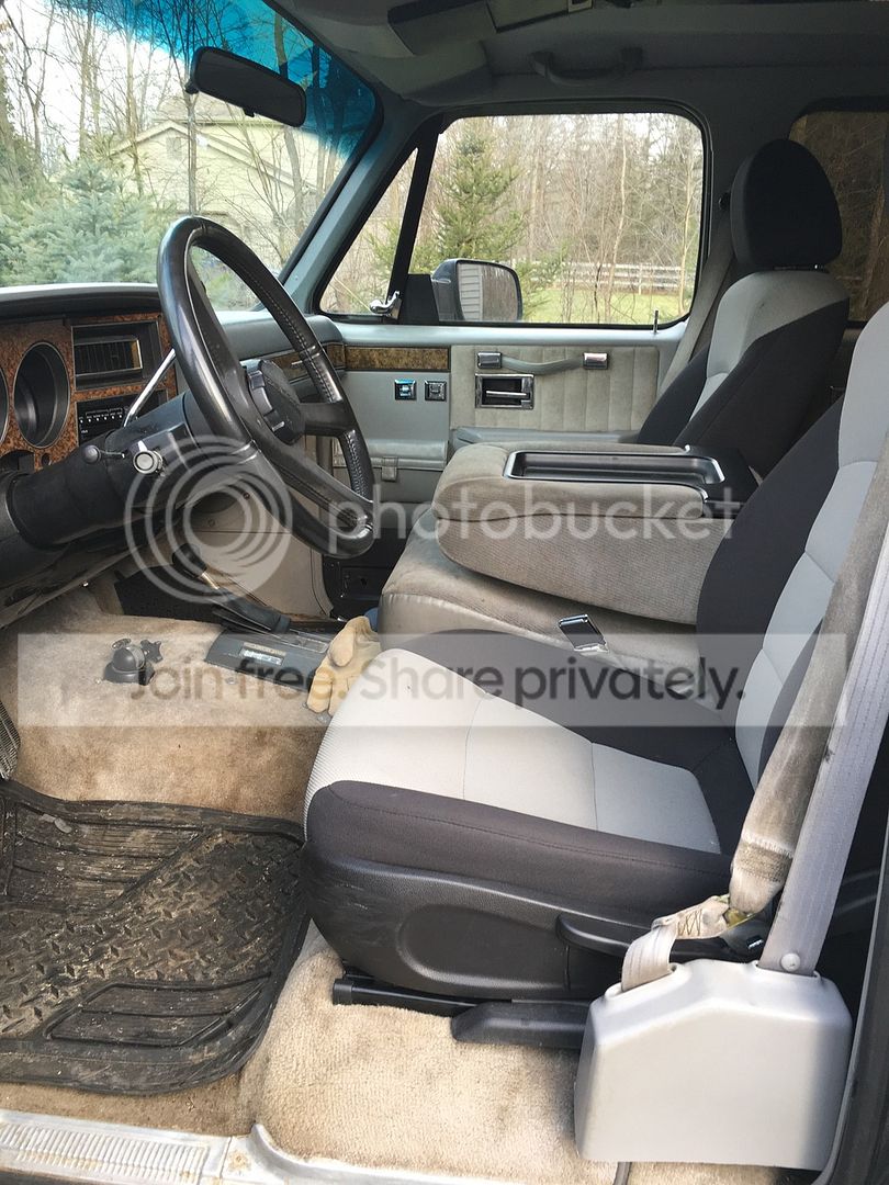

Here's a few pics bolted down with center console from 99-06 Silverado installed. The console is a little crooked. I need to bend the bracket I made a little to bring down the passenger side.
