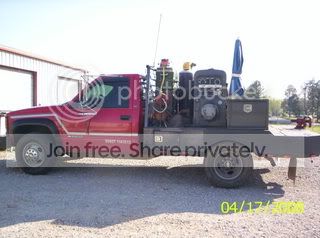

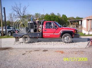

here is my rig its a welding rig 98 K3500 chevy what i have been gettin is a bad "hop" when backing up on asphalt.... not as bad on dirt.....

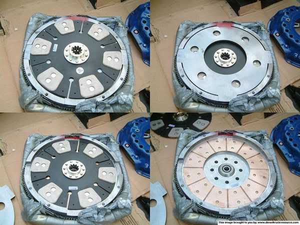

this is the south bend Dual disk ceramic 3600 I had between my 24v and nv4500. uses a 1 1/4" 10 spline input shaft though.
