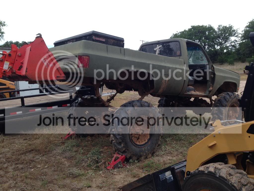

I have decided to keep my old truck alive and not scrap it. It's in pretty bad shape though. My last outing, I split the NP208 into 3 pieces. After that, I stripped the truck and built another.

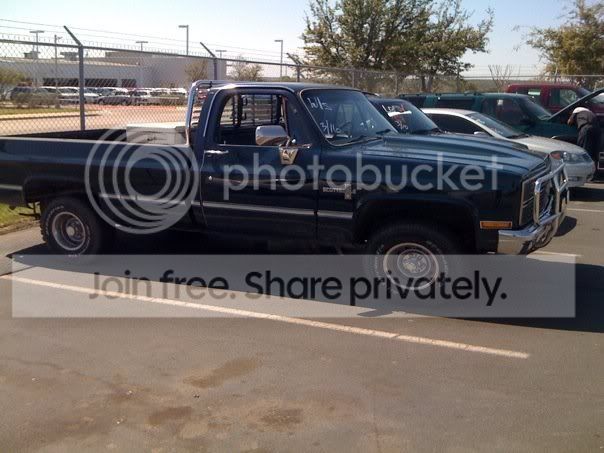

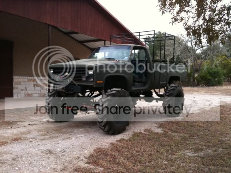

I have a 2005 Dodge AAM 9.25 front and a 2002 Dodge Dana 70U laying around with nothing to do. The plan so far is shackle flip and stock 52s, 3 link and coilovers in the front.
