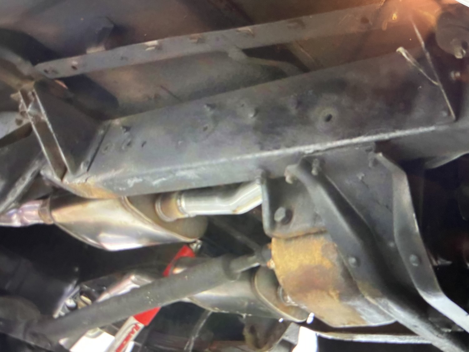

If you're gonna take the top off make sure it has the torsion boxes still in tact. That's what keeps it from folding up.
I believe they are reproduced so you can install new ones.
Is that an easy install? And does the roll bar make up for the lack of it in terms of body flex?
They are weld in, so no, not an easy install.
If it's just a stock type roll bar it won't help. The problem is the back half of the truck folding up towards the windshield. That pinches the doors and makes it hard to open.
yep, going to want something under there before taking the top off. They’re already a bit floppy when the boxes are installed.
