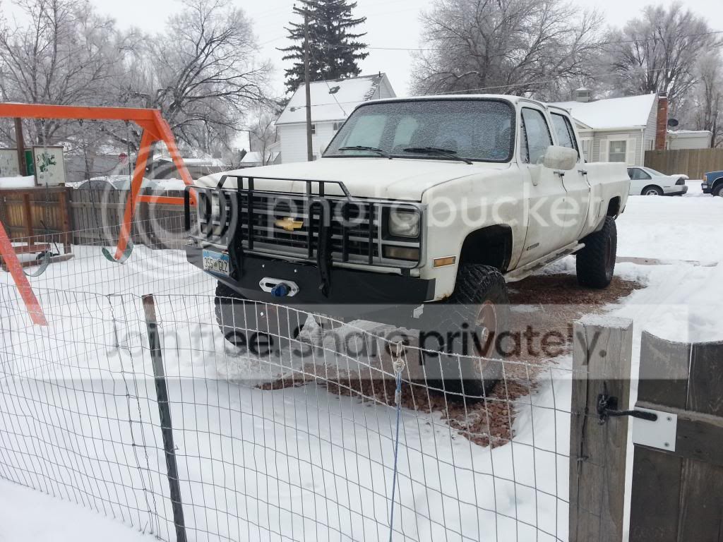

Mine is kinda like that.

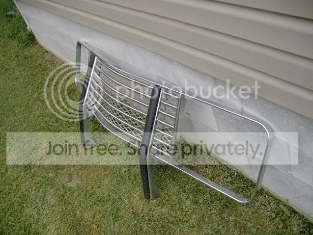

I found one of the old school type grill guards on a truck at the junkyard.
I cut some of the pieces out and welded it to the bumper. The grill guard unbolts from the vertical uprights which was a factory setup. I added tabs at the ends to bolt to the bumper as well.
I also added the bump up on the top to house an LED light bar. The grill guard mostly uses 1.5" wide 3/8" thick flat strap, including the original parts that curve around the headlights.
Probably not quite the idea you're looking for but maybe there's a little inspiration there.

Thanks. I kinda figured you were, but I thought you might be able to do the same with a tube grill guard if you find one. I noticed around here there were several listed on craigslist. I think mine was actually on a newer body style pickup but the curve around the headlights matched up. I did have to add some width in the middle if I remember correctly. The newer truck front end was a bit narrower I guess.
