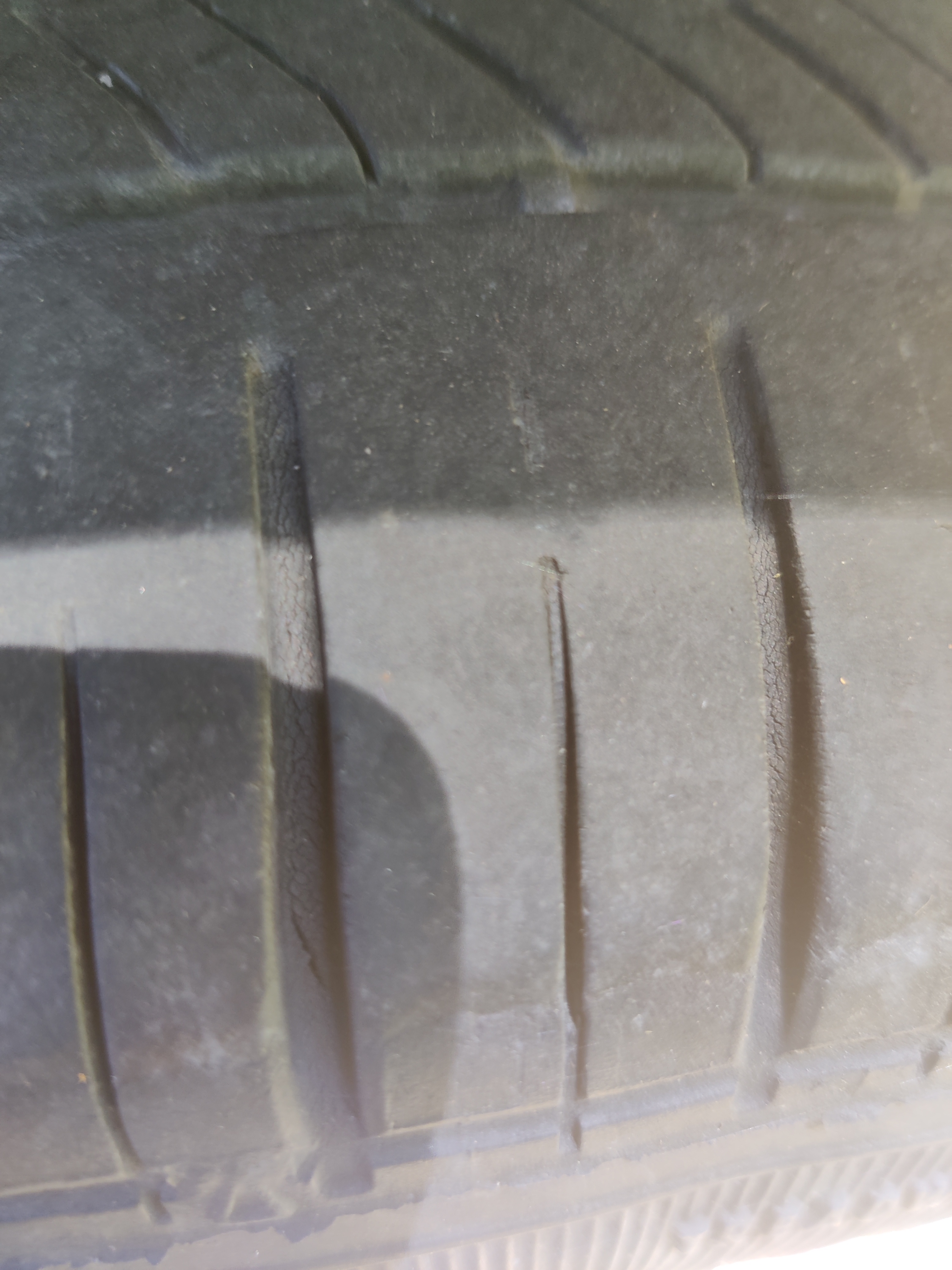

This tire is 12 years old. I've put maybe 4k miles on it in the past 8 years. I didn't realize the age or I would have considered replacing them far sooner:

Plenty of tread is meaningless. That rubber is hard and will not resist punctures nor coming apart.
My last set of BFG AT's might have gone 10 years before they looked that bad, and they were losing air out of all the tiny cracks. Before I realized they were that old I took them to an independent shop who was willing to plug a bigger hole, and after he did and tested the plug in water, said forget it, the tire is shot. Age as a factor in determining tire wearout is absolutely a thing.
