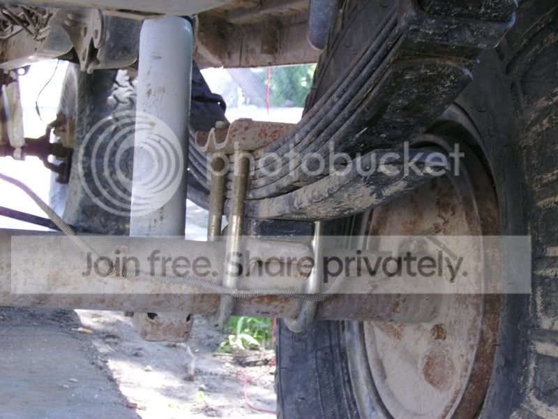

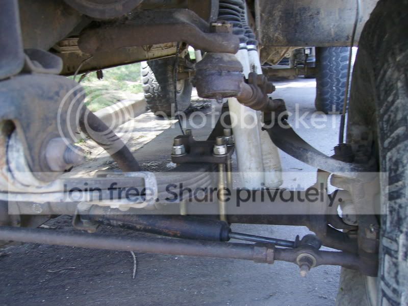

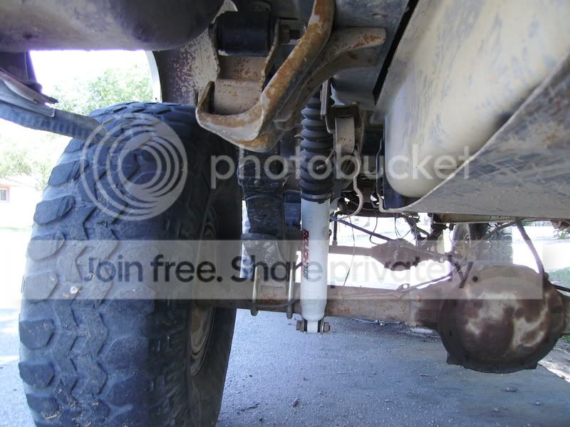

Here's what i have as of today..waiting on more parts and money since i didnt win the lottery.
so much more work to do it never ends..
