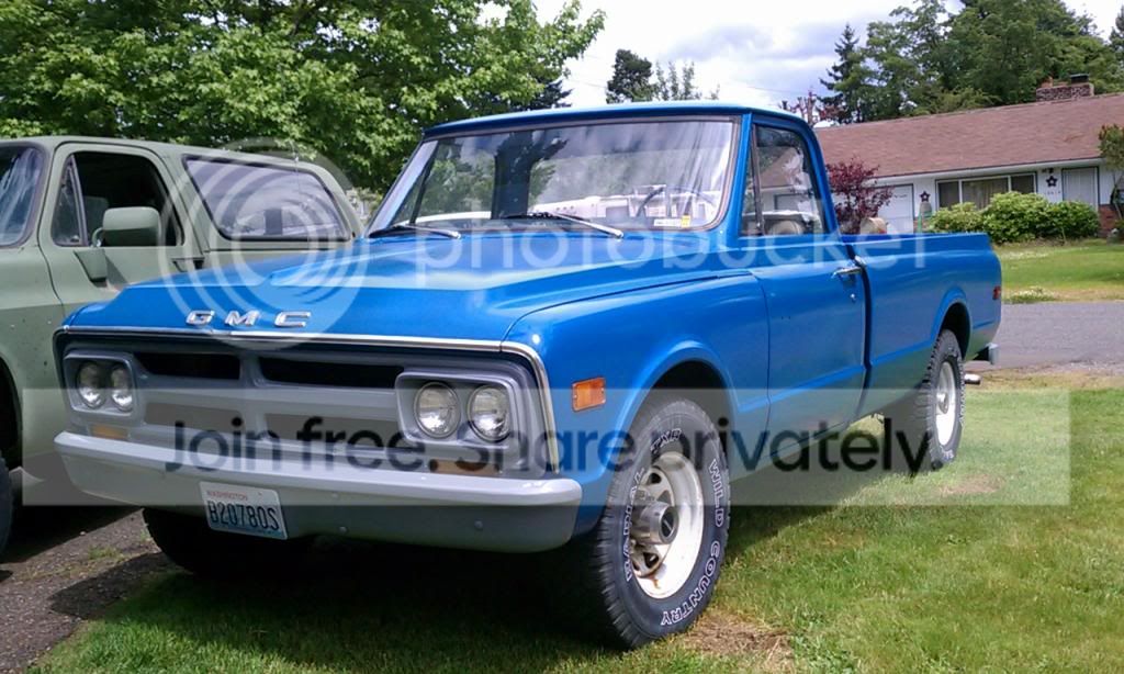

I rolled the bed portion of my 68 GMC pickup, it put on a lot of paint, I didn't even thin it like most roll on 'how to' articles, and it still turned out really good. DON'T do what I did and forget to use a FOAM roller :haha: I forget how long it took me to sand the lint out. The only down side if you don't thin the paint, is you'll get a lot of orange peel, and w/o using a hardener, it takes weeks before you can sand.
I bought basic rustoleum that was some shade of blue cause it most closely matched what color the truck already was. I probably didn't use a gallon. I had to buy it in qts though, cause no one carried this specific blue in a gallon nearby. I think it was $30 at Lowes for a gallon? Pints were like 9-12, I forget. Going cheap, just use rustoleum. They have gallons of primer too if that's what you'd like to do. BTW I didn't sand this to metal, OR prime it. It was just my first attempt (other than the rattle can) to get a decent finish. Only spots I primed was where I was rusting and took it to metal.
Here's a pic of the truck I painted, HF spray guned all but the bed. Rolled that on.
