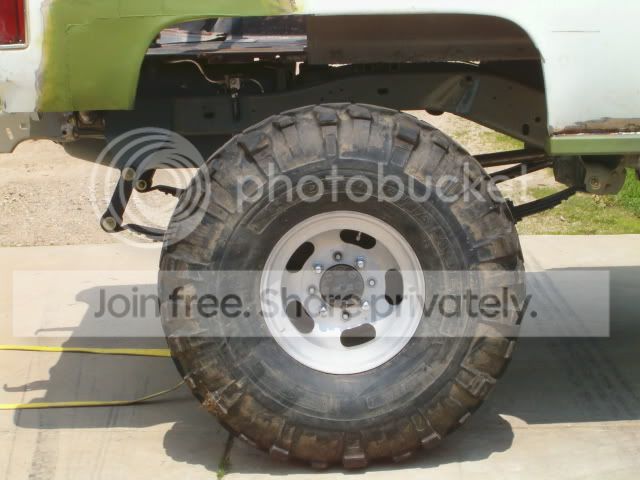

I sectioned my wheel opening and moved it back 4" to make the tire centered in the wheel opening...still ain't looking to pretty but you can see the cut and weld sectioning going on here.

Truth be told, I'm looking more for images that show how this is done on a curved fender (for obvious reasons! :wink1:) on a squared fender, the sectioning can be pretty srtaightforward, because the cuts get made areas where the fender lip is nice and linear.
If I try to do a tradional "section" job on a round fender lip, I'll end up with an awkward straight-ish transition in the area where the stretch happens. My pizza slice idea works, but it's a ton of work and welding/finishing. Im looking for other ideas that the pros use to make a small round shape into a larger round shape in a more elegant way than what I already tried.... :thinking:

Thanks bud! Using the Pie method works good on round fenders, but you would have to increase the overall diameter of the opening, which may be your intent. I was just merely raising them, so it would work on ANY fender shape.
Lengthening can get tricky, but you just need to find the apex of the bend, cut, splice and weld.
