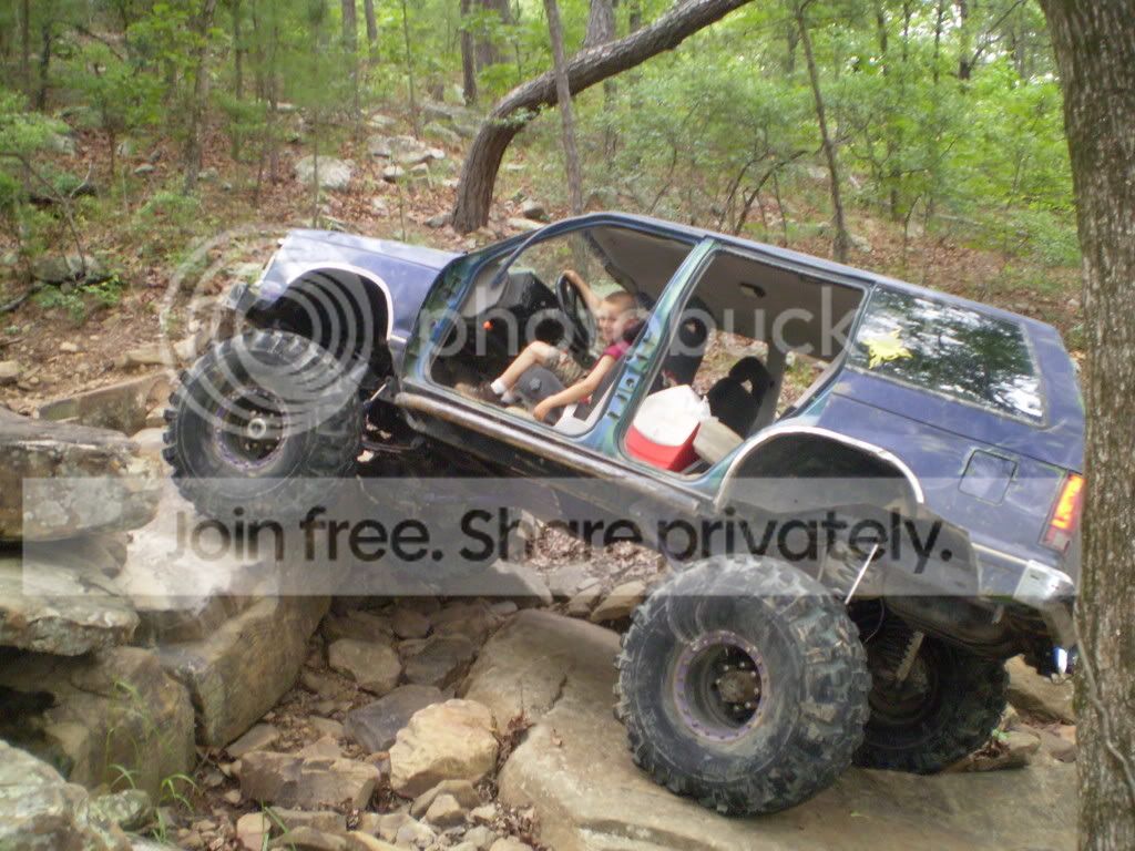

saw this pic in another thread, think it was posted by original blazer, hope this is what you were looking for.:D
sorry, i jumped the gun i believe that this is a standard cab truck frame.

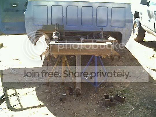

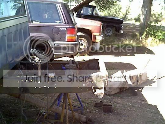

Mine is actually a cab and chassis cut down to 4 feet behind the cab.
It was 9.5 foot frame rails with an 10.5 foot bed on it.
