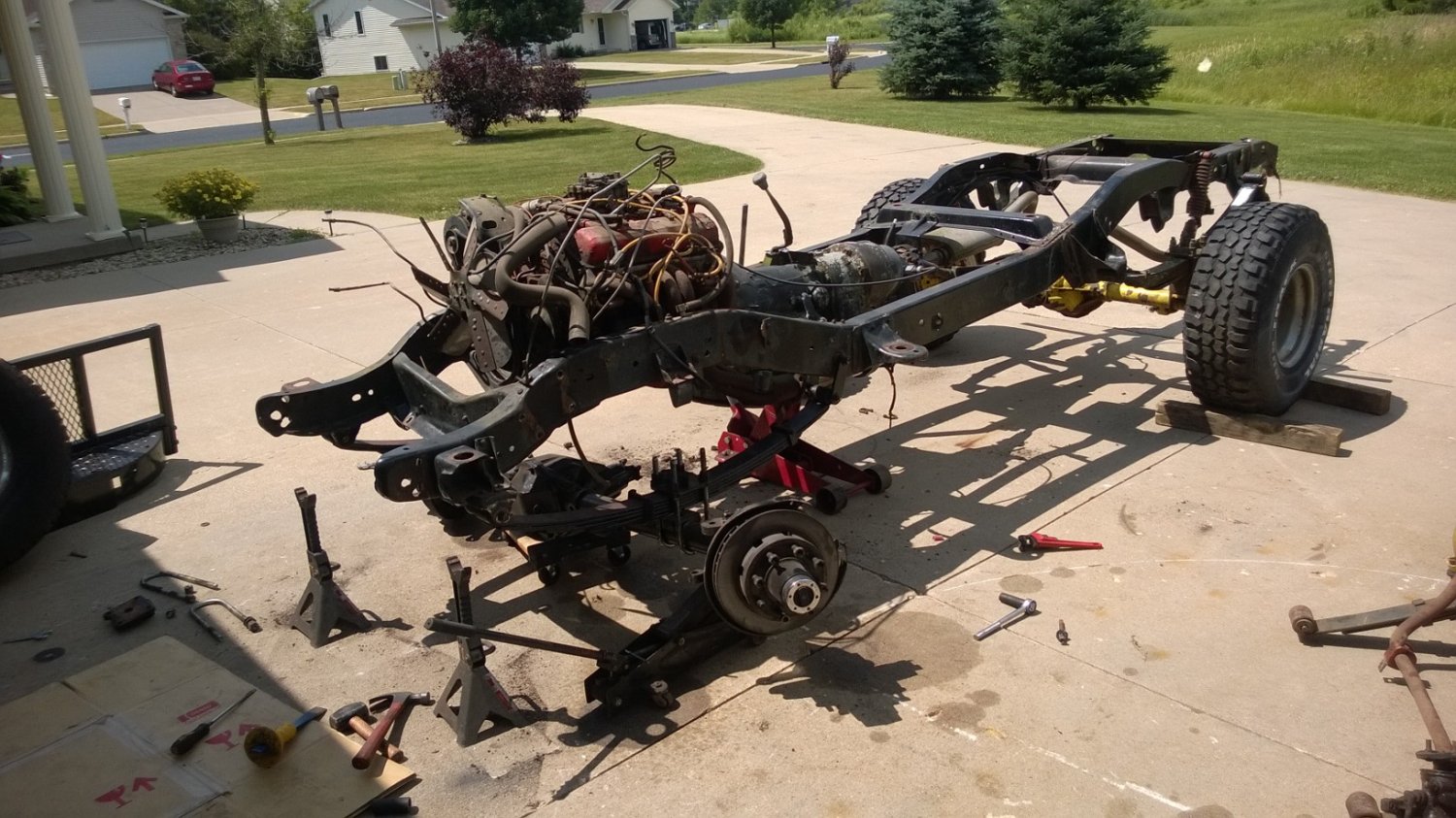

I'm excited to get to the suspension part! Today I'm working on cleaning up the new frame. I'm thinking about welding some more bracing in the frame. Also been talking with Kert about some boxing
I used Kerts box kit. Its a good starting point. Make sure you get the right year. In hindsight it would be easier to remove cross members and make your own cross members. I also boxed mine.with the body on it (PITA).

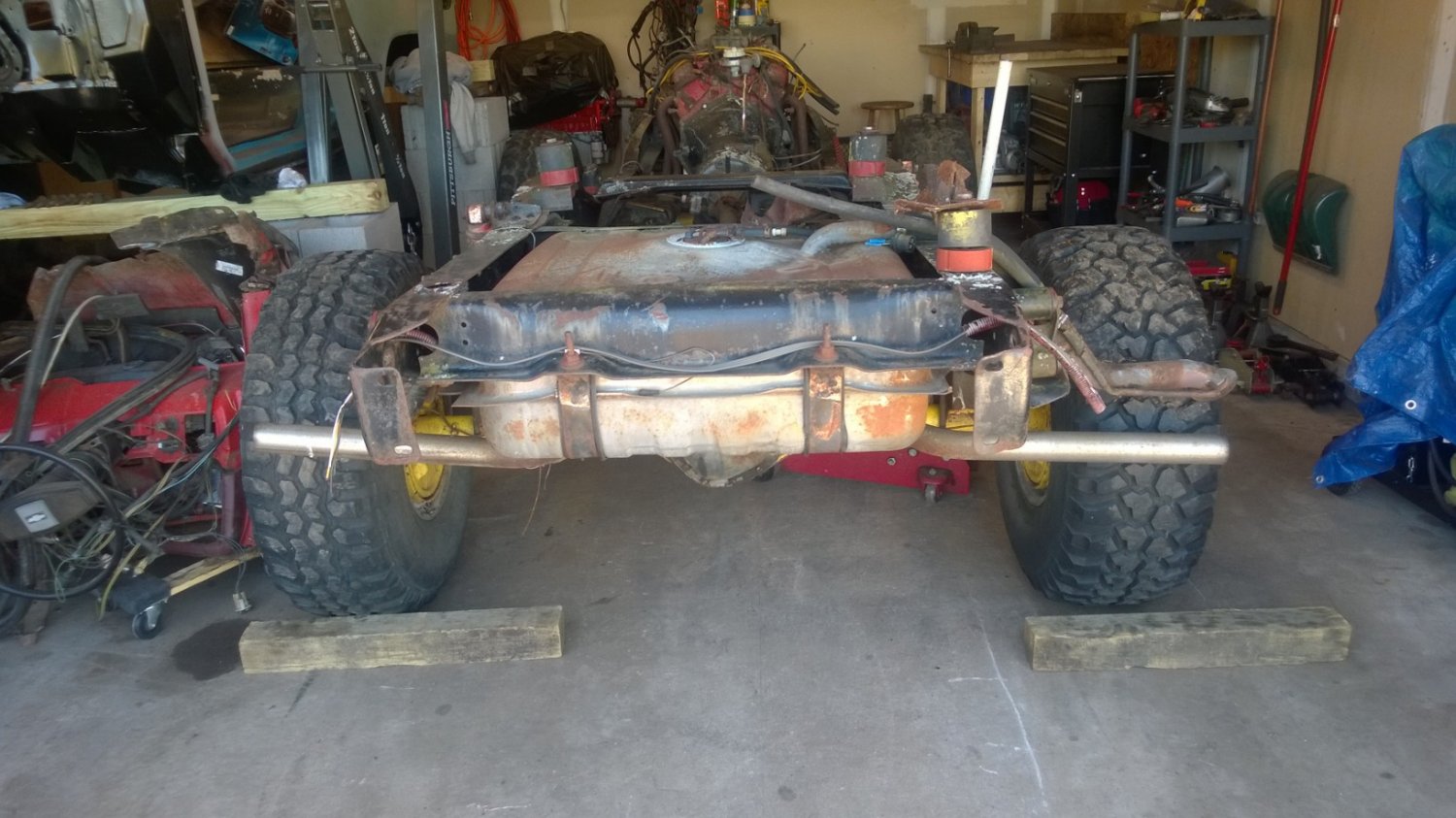

After doing some contemplating and figuring how am I going to be able to get this blazer done before September next year I decided that the frame I had needed too much work and had to go. It had a lot of pitting and thinning making me want to get into boxing. Ended up finding a rolling frame (3rd one is the charm) that was redone at some point in its life. The frame was straight and had no major rust issues. It is going to need to be cleaned up in some spots and some new paint added. Also decide to go with more of a stock drive train and mild 4 inch suspension. Going to keep it looking more stock then what i was planning in the beginning. This should make things a little faster to get done. Going with a carb 350 th350 and np203. Going to use my dana 44 and 14 bolt rear with 4.10 gears. The dana 60 and ls stuff will be saved for a future project.
