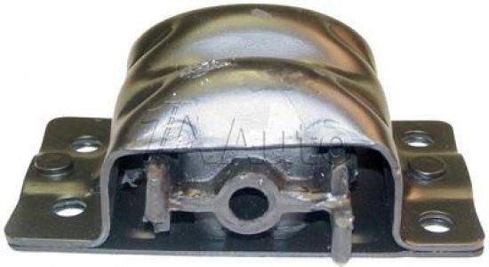

If the engine mounts are supposed to look like this:
Then yes, I have a "rubber" problem :eek1:
I think now that I see this picture I'm beginning to better understand the anatomy of an engine mount. The throughbolt goes through that hole in the picture above. I think tonight will be a better night in my attempts at removing the engine mount.
Those are urethane mounts that replace the rubber in your original mounts. If you use urethane you MUST use urethane on the t-case mount as well. Using two different types of mounts (urethane and rubber) is the easiest way to break a transmission case.
