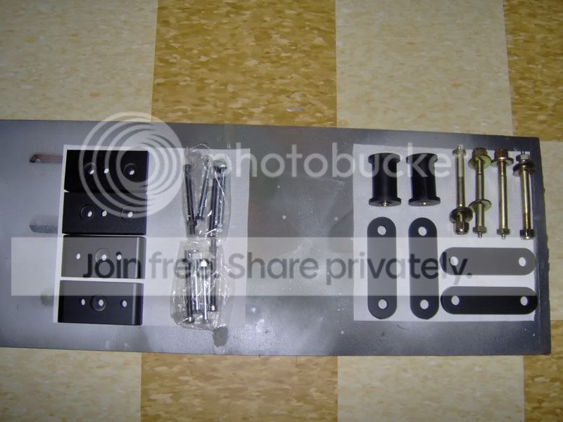

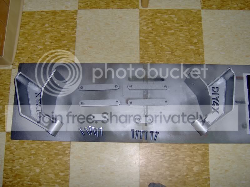

Finished painting my supension stuff this morning. I`m pretty happy to get it done....
Here`s the shackle flip with backing plates and supplied bolts...Kert really does some good work, thanks again Kert!:waytogo: For paint, I went with Rustoleum`s Hammertone Grey, and I am very pleased with the way it came out.
Here you see my zeros and shackles and supplied hardware. For this, I just went with a basic satin black, keeping it simple. BTW, these shackles are sweet! Nice and strong, ready to take some abuse!
Overall, I`m pleased with the way things are coming out thus far....
cool...have fun popping out those rivets for the flip :) Keep us posted...
Oh look! Centering pins...rofl
bigblazer87 said:
:haha: :rotfl:
And Avery, those rivets aren't bad at all with an air chisel.
Those rivets aren't that bad when you cross cut the heads with a cutoff wheel either. That and a hammer and chisel is how I removed all of mine.
