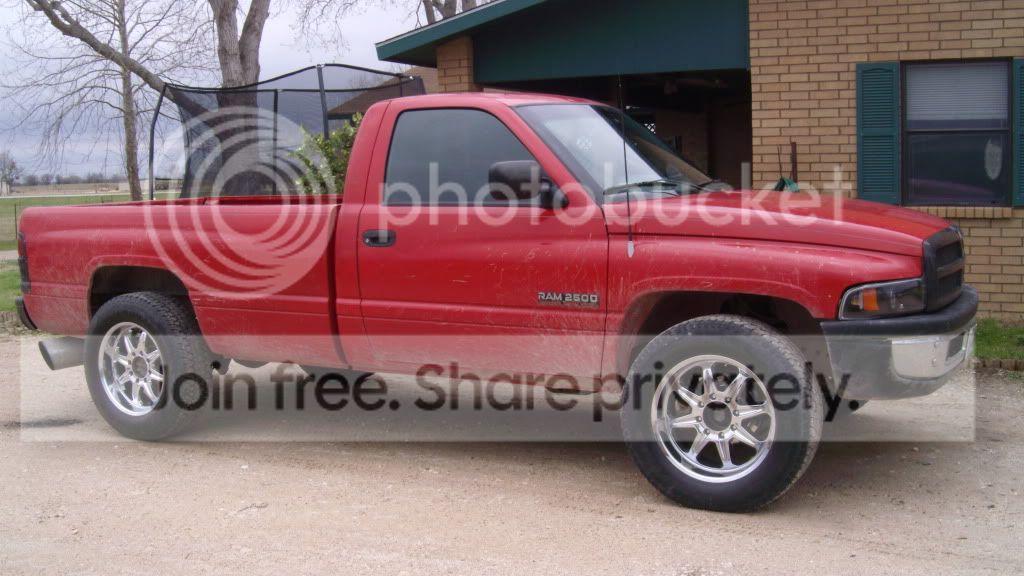

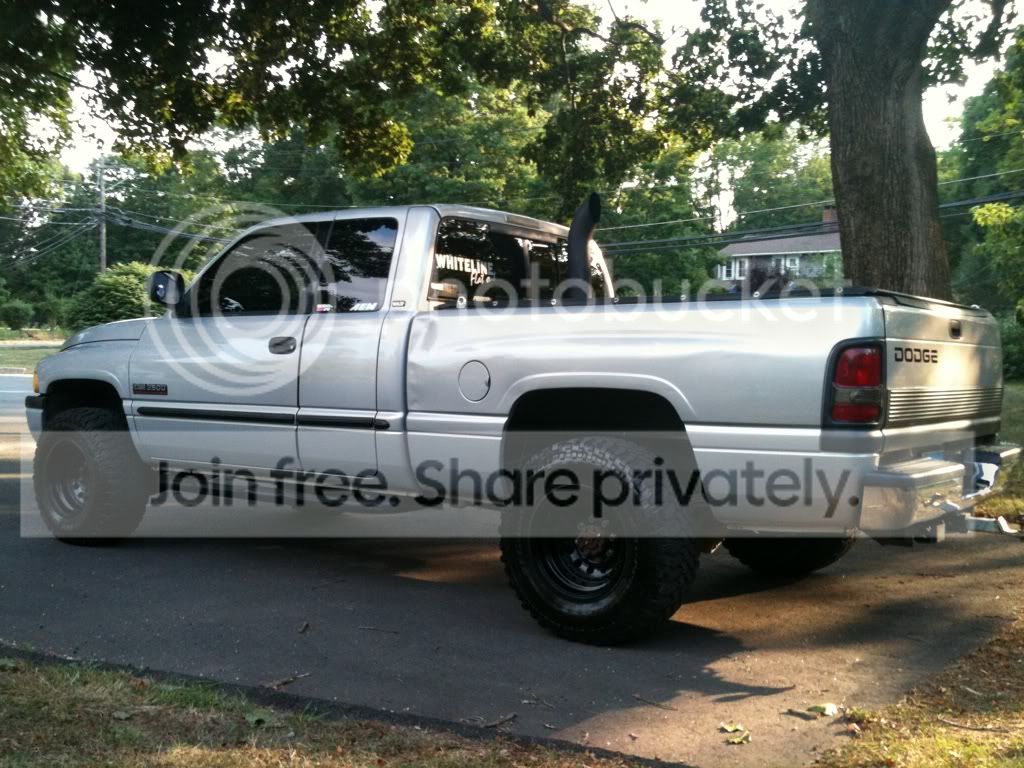

Heres an Idea(s) of what I'm shooting for.

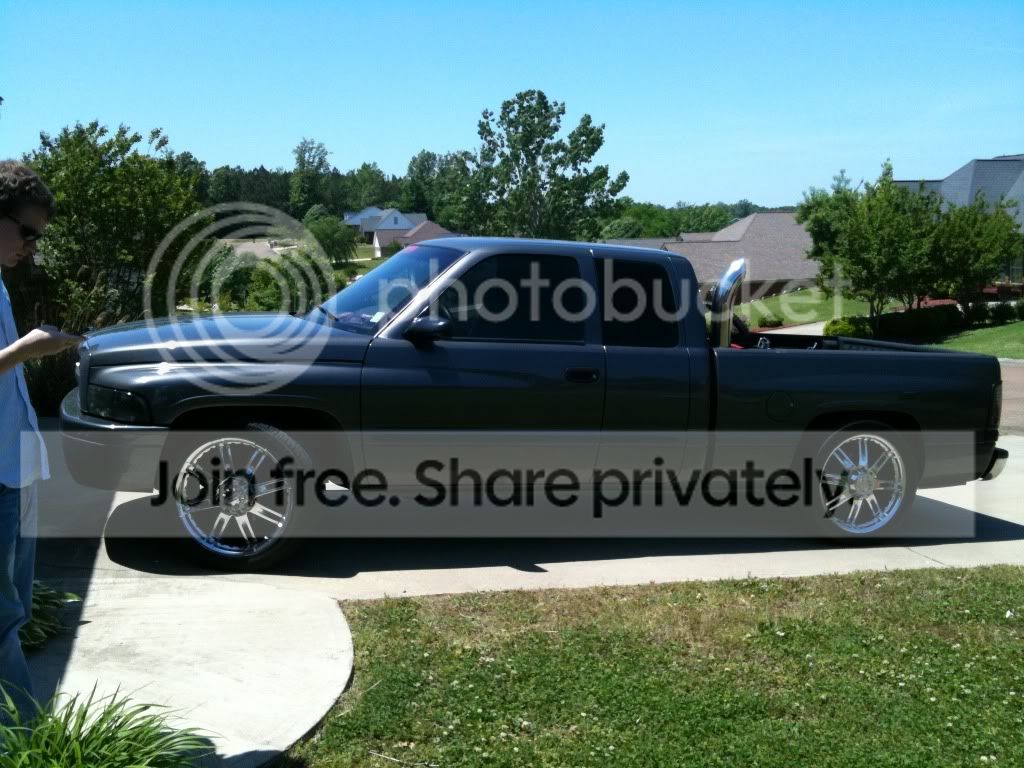

I think I want to black it out too
It looks kinda cool and everything on this truck doesn't look too good so painting it body color (gun metal) or black will make it look nicer
It shouldn't be looking the same for long :D

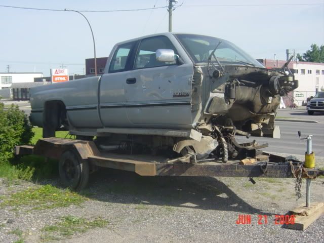

I found a extended cab that had a cummins for $800 bucks. It about an hour away. It has a gooseneck hitch already and the bed isn't rusted out. And what body panels are damaged are in good shape on my other truck. The dash is cracked also, but it's not on my other one and the gauges seemed to be in better shape.
Seems like I cant go wrong there
The extra wheelbase will probably help towing also, we plan on getting a gooseneck to hold two trucks, probably about 15k pounds.
