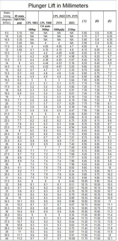

who ever you get in there doing it. make sure they're setting timing with plunger lift. and using the correct lift chart for the pump number.

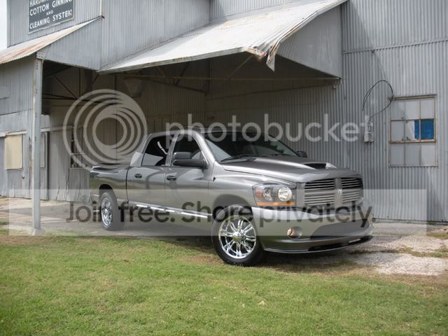

Going to look at some 20" wheels and tires Saturday
I think I'm gonna make a gooseneck hitch

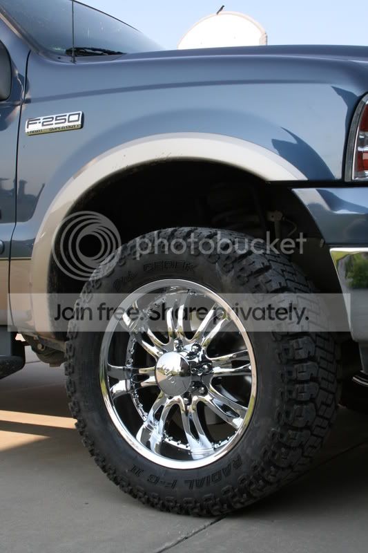

I think I'm going to get these wheels.
What color should I paint the truck?

I'm going to with these wheels about this size for a tire
And I'm going to do my front like the one shown, but with a white grill
Edit: another of the wheel, too blingy, I know
