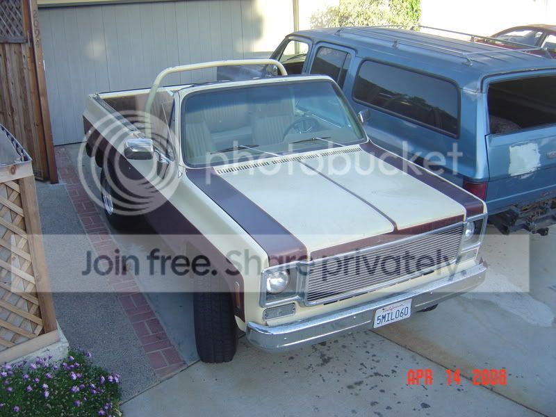

well I got my engine for my 75 jimmy, I need a name for this project!! some teaser pics
98 military hmmwv 6.5 turbo diesel with trans and np242 t-case
