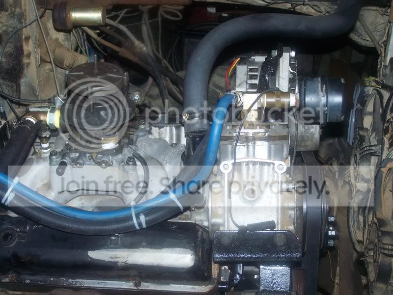

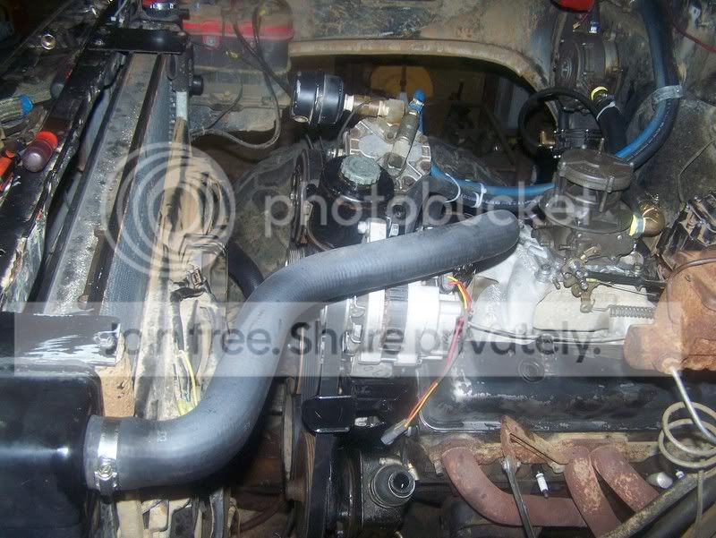

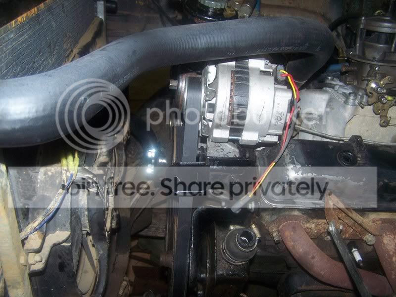

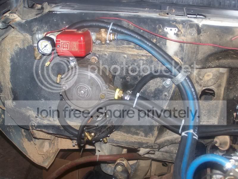

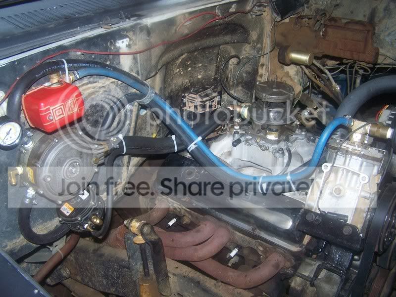

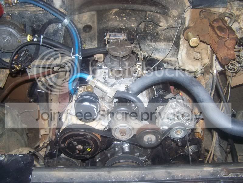

I've got pane on my "stockish" motor. 72 4 bolt main, stock bore, big comp cam, Edelbrock air gap intake, headers. Nothing fancy about my heads. Runs good. A hot spark would be nice and also new dist curve springs to make the advance kick in sooner.
