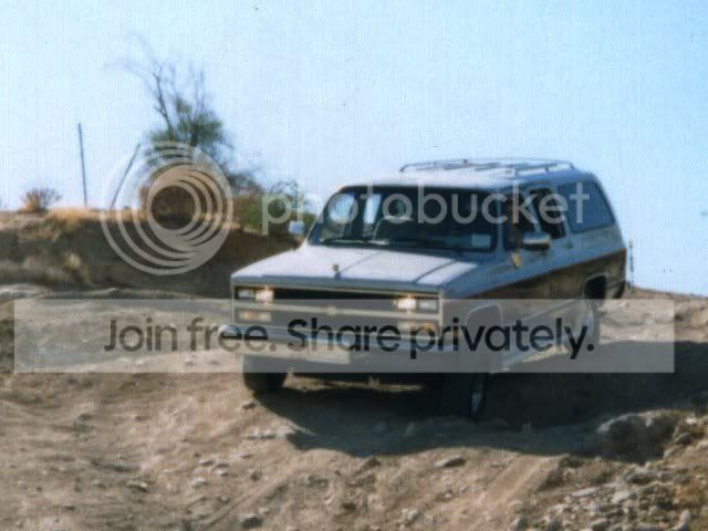

you start beefing things up, it will go from this

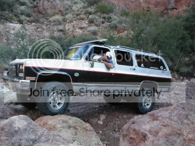

to this, and i don't even have any recent pictures of the extra damage that's on the driver side from the last wheelin' trip:p:
There was only one small dent in the front passenger fender when i got this truck, not the complete driverside rear quarter panel is totallt caved in, bumpers are tweeked, dented, every bit of rocker panel is dented, i honestly don't think there is a single panel on this thing now, that doesn't have a dent of some kind in it :D but it was fun.

Your before pic looks like mine now. Though I hate those running boards on my truck they sure do help when loading and unloading babies.
