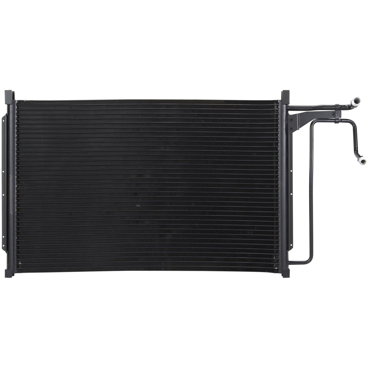

This is what Rock Auto has... doesn't say R134a. Can you guys tell by looking at it if it's old style or new?
That is the newer, R-134a friendly cross flow type. Notice how the cross tubing is flat and very densely packed with cooling fins?
That looks like the piccolo tube design, which is better than the original, but parallel flow is better.
The parallel flow one is 7-3642. It is not listed in your application, but if you check the OEM numbers, it will cross.
You can find mixed reviews on it, as well as the ACDelco one that is parallel flow.
3642 looks to have slightly different connections. Will it line up for me?
Looks more like camera distance as to the width of the fitting to each other. One is AN-8 movable hose from compressor and an AN-6 to the hard line to the bottom of the evaporator.
I put a 3642 in my '90 A couple of weeks ago. It hooked up to the hoses fine, but as some had posted in reviews, (Amazon was one place) you have to move the mounts. I can't help you decide what route to take, as I am unsure if the piccolo tube design is a large amount less in efficiency. I discovered after I got the 3642 condenser, that I had a piccolo tube design one in my used parts stash...
I took it out of an '86 that it fit well in....
The Delco condenser has been good and bad in reviews that I found too...
The only advantage to tube style is that it can be flushed. I've heard of compressors blowing chunks when they die, but I think it's pretty rare. Has anybody done an A to B comparison where they had the stock large tube condensor on a square body (properly charged and running) and swapped it for a parallel flow one while changing nothing else?
I read the reviews on Amazon and don't want to bite off the frustration of non-fitting stuff. I did order the one from Rock Auto. Hopefully better than baseline and now's the time while I have everything apart.
So you got the piccolo tube design?
And I have had 2 of the R4 compressors puke metal in my '90. I know one was a parts house , Chinese unit, and the 2nd was used. It was quiet for 2 years, then in about 2 months,,,,,
I put an ACDelco on it now.
Yeah. I get that it's not ideal, but hopefully better than original factory.
I definitely understand your decision.
If there was a known, perfect fit parallel flow condenser available, I may razz you though!!!
:rotfl:
