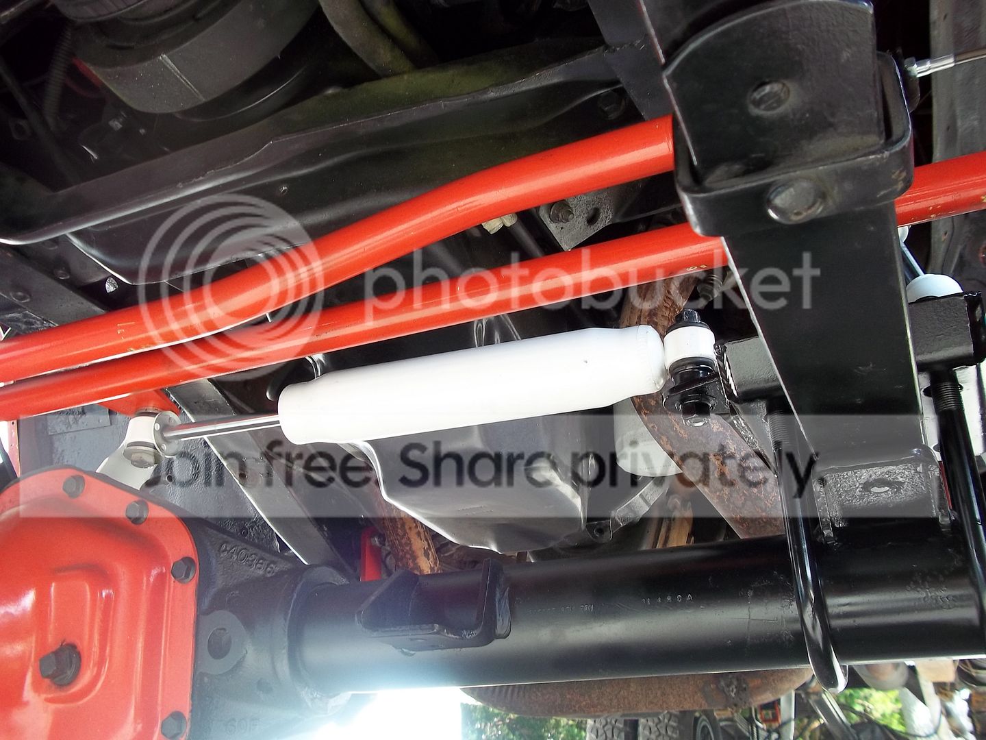

love the 4"s in Mutt.... ride freakin awesome... whoring...
we'll see how they hold up to the BB weight tho... :popcorn:
