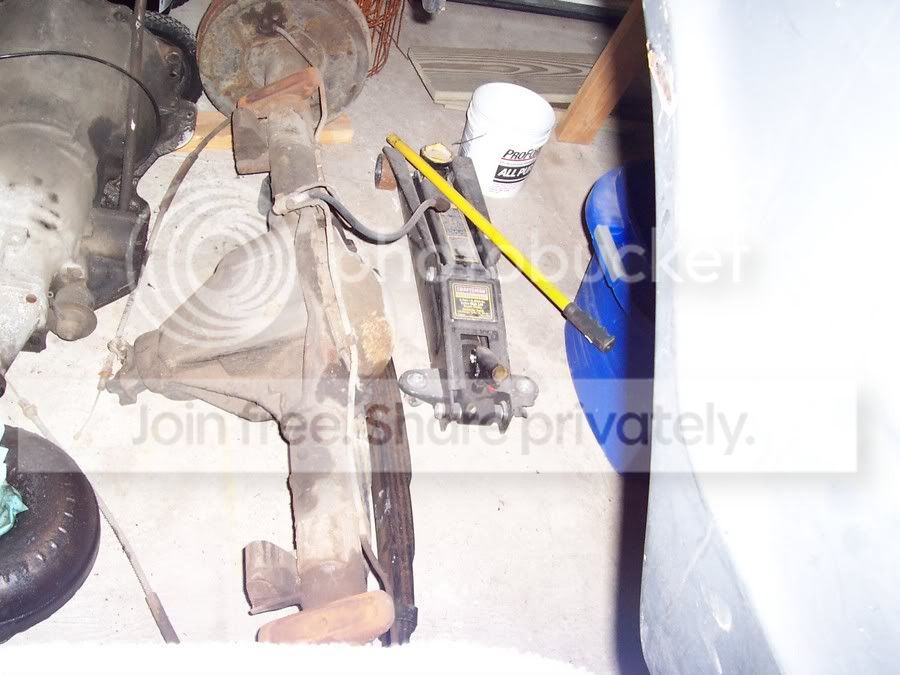

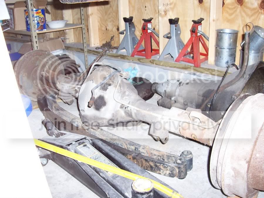

JIMs70K25 1/2 ton status Joined Dec 31, 2001 Posts 523 Reaction score 0 Location Chesapeake, VA May 12, 2005 #2 This came out of a 71 C20, spring spacing is 42" I believe the 4wds were 40".
R R72K5 Banned Joined Mar 5, 2001 Posts 8,905 Reaction score 0 Location central IL May 15, 2005 #3 42.5 on 2wd and 10/20 series 40 on all 4x4 and 1 tons pre-73 and this only goes for leaf spring equipped ones, there were some that were coil rear so watch out,, ive had a few of these 72 oldr d60 axles alot of them are powrlok equipped and you can get these axles super cheap 150 bucks or less, and they are 3.54(opt), 4.10(opt), and 4.56(std)
